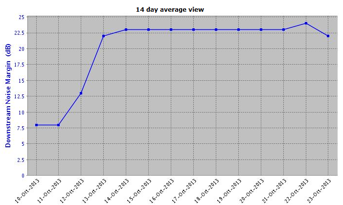

Hi
Could one of the Digital Care team post my visual radius logs please?  I've just noticed my usually solid 8Mb connection was syncing at 4Mb.  Just rebooted and it is now up to 6Mb.  It looks like my SNR Target is up at 15db.
DSP Firmware Version A2pB025f.d22k
DMT Status No Defect
Operational Mode G.DMT
Upstream 448
Downstream 6144
SNR Margin(Upstream) 23.0
SNR Margin(Downstream) 15.3
Line Attenuation(Upstream) 12.0
Line Attenuation(Downstream) 21.0
Phil

Hi Phil, Sure.
<img src="http://community.plus.net/visualradius/generated/image13826036475296.png"/>

Thanks Adam
That looks very odd.  I can't think of any reason why it would have been off on the 12th before 7pm.  The disconnect last night will have been when I rebooted in order to get my speed up a bit.  So when did my speed halve?
Are you able to see when my profile went down from 8 to 4 and my SNR increased to 15db?
Phil

Re: Radius Logs
You had connectivity prior to 7pm on the 12th, just a bad one;
<img src="http://community.plus.net/visualradius/generated/image13826159367855.png"/>
It seems that too was when the noise on your line changed.
We can place a SNR reset for you to bring this back down since your line has been stable.
