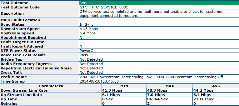

Morning guys,
I was wondering if I could get a screen grab of my current line stats (sync speed / snr etc) and a radius graph for the past few days so I can compare before and after the boost engineer visit tomorrow please  Smiley
Thanks in advance
Mark

Forgot to mention I'm on fibre so can't see my own stats Sad (unless I invest in an unlocked modem)
Posts: 5,369
Registered: 13-07-2012
Re: Quick Stats Request
See below the stats for your line and a visual radius graph:
<img src="http://community.plus.net/visualradius/generated/image14077636816516.png"/>

So the "boost" engineer attended, said there was no fault and left  Roll eyes
I thought the point in getting a boost engineer rather than a normal fault? one was because there was no fault but the speeds are low. He didn't even bother checking any of the cabling from the house to the cab, I was under the impression that this is what a boost engineer is meant to do? Plusnet asked this on the ticket in the engineer notes but it looks like he's decided to completely ignore it.
Basically no further forward Sad what's the next step? How can we get an engineer out to actually check / replace the cabling? The last engineer mentioned there's something causing it on the d-side somewhere but a boost engineer would need to be booked to check it.
EDIT: Just to add, the engineer also told us that if we downgraded to the up to 40Mbps option we'd only get 20Mbps, which didn't strike me with confidence regarding anything else he was saying...

We've received the notes, however these do look like standard SFI checks were carried out from what I can see.
I'll do my best to get our faults team to pick this up again for you ASAP.

Thanks Adam, yeah they were but he never did any of the things that plusnet requested on the ticket, or any of the things I was led to believe a boost engineer is supposed to (check / replace all joints back to the cab etc)
