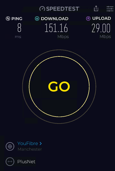

The other posts cover the points I would make, but there is a sharing mechanism, if you can fully utilise the Internet connection.
With one device (on a wired connection) run a speedtest (say Ookla) and see what it says.
On the multiple thread test it will probably fully use both download and upload.
Then with two devices (both on wired connections) run two tests at the same time, the achieved speed will probably be roughly equally split between the two devices.
It will be less than the single device test achieves.
It's your devices, not anything Plusnet is doing to your connection.

I tried my suggested test (Plusnet 150Mb/s fibre) - One device
One speed testOne speed test
Two devices (both cabled to the router)
Two speed testsTwo speed tests
There is a practical difficulty in that I couldn't quite trigger both tests at the same moment so there is slight "flattery" on the two device test but it's clearly less than a single device and does show the connection being shared between the two devices.
