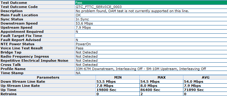

Chris ran a test on my line and found errors which might be causing issues for me - see the attached.image.
The fault is detailed in TR0000003665233.
I cannot run the test Chris did so cannot tell you if it has been fixed.

Thanks Adam - could you run the test Chris did just to confirm that the line errors have gone.
Message 5 of 9
(646 Views)
Re: Question 87683791 - Question closed automatically after 14 days of inactivity. ?
18-07-2014 11:46 AM
Sure, only a handful of errored seconds are showing which shouldn't be a concern.
Don't panic about the big red "Fail" at the top, that's there as the KBD (BTW's diagnostics system) indicated the PPP session was down and that isn't reflected on your RADIUS logs which indicate that you're currently online.
