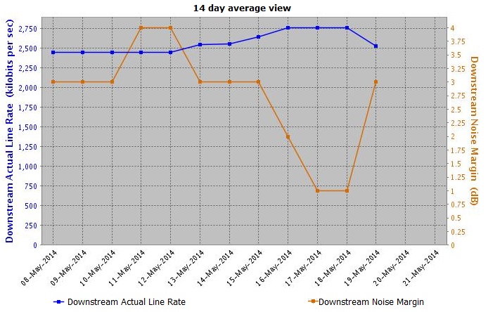

Hi Ian,
Your line has fluctuated recently with sync speed and the SNR margin which has had an adverse impact on the DLM, your line has also been disconnecting intermittently.
Your line speed has dropped to it's lowest point today for some tome with a sync rate of 1.6Mb/s.
<img src="http://community.plus.net/visualradius/generated/image14007599044566.png"/>
Do you have a test socket you can connect to?
Also, do you have any interference/crackling on your phone line?

Re: Profile dropped from 2.2(ish) to 1.3 on ADSL2
22-05-2014 2:19 PM
Hi Chris,
many thanks for yr quick reply.
The D/S SNR/Speed graph seems to confirm my routers
info with a usually stable SNR around 3-4 db.
I will try connecting to the test socket after posting this message.
So you will probably see the line go down again which might upset the DLM.
I have done a couple of 17070(2) calls today and they were both clear
as a bell .
Ian
22-05-2014 2:31 PM
If your line is stable once you're in the test socket we'll be then reset it and hopefully you'll see a speed improvement.
