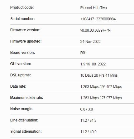

Just wanted to ask one last question, my Max data rate is consistently hovering around 28Mbps, but my data rate is 1-1.5Mbps lower and hasn't budged in days. Is this normal? Would it be worthwhile for a reset somewhere?
Only asking as the Max data rate and data rate values for upload are matched exactly.
Thanks for your help guys! 🙂

So the Hub 2 Sync rate on the Tech Log has now increased to 28.8Mbps (upload still same at 1.2Mbps ish) but the Max data rate has stayed the same as before... 27.977Mbps...
How can that be? 😅
I'm now achieving a reliable 25.4Mbps download which is significantly better than before.

@MDEV  To explain your query about the Max date rate.
It is not a real achievable speed but a value displayed by the modem as a theoretical max speed based on some calculation using the line stats. Usually it is higher than the actual sync speed but it can get it wrong sometimes and show a value below the sync speed. Noting to worry about, just looks a bit strange.🤔
