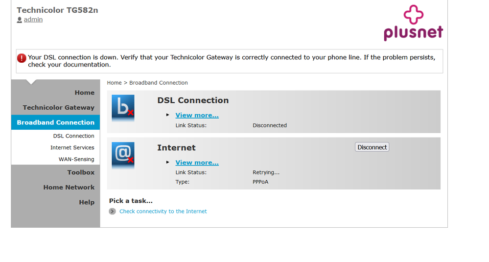

Hello,
I have run multiple line fault checks via the plusnet bot reachable by text message. The bot reports the line is okay but I am still having my connection drop randomly regardless of the hardware I use. The connection is perfectly stable until the connection drops, at which point it will struggle to regain connection from anyway between 10 minutes to several hours. Rebooting hardware does not always guarantee a reconnection.
I have tried 2 different routers, 4 different micro-filters and various RJ11 and RJ45 cables. The problem is exactly the same with all hardware.
I have noticed on my own Router that my SNR margin is all over the place, jumping from up to 8 all the way down to -3 in the span of a minute
Please help!

I have just noticed the connection appears completely stable until I introduce more than 1 device to the network, at which point it almost instantly disconnects.
Currently getting a stable 24,382kbps on my PC

Just got another drop using only one device after about 2 hours of no problems

The bad news is it looks as though you've got REIN.
The good news is that you have a good old TG582n and they are a dream router compared to some others, in that they really do lend themselves to being monitored using router stats.
You can download the full version of routerstats from the link below and then configure it for the TG582n using the other link.
