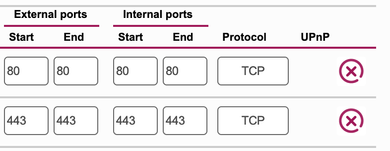

I'm trying to port forward port 80 so I can access my security cameras on the internet.
In the router's firewall settings I've set it like so:
Then I found out my public IP (also on the router's status page). But accessing that directly just times out, and setting a DNS record pointing to it doesn't work either, timeout.
I have a static IP which I set up today, and it said it would work right away after router restart (which I did).
Top of the router admin page says "Plusnet Hub Two", so that's my router.
Any idea what could be going on?
Thanks.

I've got a reverse proxy to an interface showing all the cameras, so I only need to port forward ports 80 and 443.
The thing missing from the port forward screenshot is that these port are going to my home server device.
All working fine on localhost with a port number, just can't access it externally.
Just not sure what I'm missing here, all the settings seem fine, is the public IP not the `Broadband IP address` from the status page?
Where my settings are port forward 80/443 and then an nginx reverse proxy on my home server handles the rest.

I just mean I can connect to it just fine on my local network `server_ip:5000`, and `localhost:5000` on the server itself.
No logs coming in about port forwarding, not when I visit my public IP, nor the domain with the DNS record pointing to that public IP.
Is your fixed IP address working yet ?
Always get the same IP at least, and that's the IP my DNS record is pointing to.

If you are connecting on port 5000 on your internal network, why have you set up forward rules for port 80 and 443?
Broadband IP address: on the status page is your public IP Address
Re: Port forwarding doesn't seem to be working
12-11-2023 7:27 PM
The service itself is running on port 5000 but I don't want to expose that, so I've got an nginx reverse proxy on port 80/443 that forwards to those services running on the box (so I can force https). I can also connect to `server_ip:80` and `localhost:80` just fine, just shows the nginx message, which I would expect to see when visiting that public IP address.

To me this is rather odd, you don't want to expose port 5000 but you are happy to use ports 80 and 443 ?
I would have created a rule to forward say 56067 outside to 5000 inside.
a working port forward rule would look something like
I used to run Zoneminder all I did was http://<my public IP>:56000, the port forward rule was outside 56000 to inside 80
I like to keep things simple
Edit: this site will help to see if the rule works https://www.yougetsignal.com/tools/open-ports/ or https://www.canyouseeme.org/ it is important the application is listening for connections
12-11-2023 7:51 PM
I just want more control than exposing the whole service, security reasons, so the flow would be 80 -> 443 -> 5000.
Also got a DNS record pointing to the public IP, myservice.mydomain.com.
Request comes in on that domain, nginx forwards to the internal service on port 5000, and doing the http -> https if needed, with a lets encrypt cert.
But it should work the same way, just port 80 instead of 56067, doesn't make any sense why it's not working.

Thanks for the links, guess this explains it:
> Port 80 is closed on [public IP]
It's just not working.

I'm currently facing the same issue. I operate several services that require external access, and everything was running smoothly until a few days ago when it suddenly stopped working. Despite multiple attempts at configuration resets and gaining a few grey hairs, there's been no improvement. Port forward checker websites indicate that all ports either time out or display as 'closed.'
While internal access within the LAN with specific ports remains unaffected and work as intended, external access is being blocked. At this juncture, it seems plausible that the issue lies with Plusnet blocking the ports being forwarded.
I hope a resolution can be reached sooner rather than later, and do we know if Plusnet are aware of this?
12-11-2023 8:28 PM
Good to hear it's not only me, because I'm pretty sure all my settings are correct, but the port is just always closed, even tried other ports than 80, same story.
