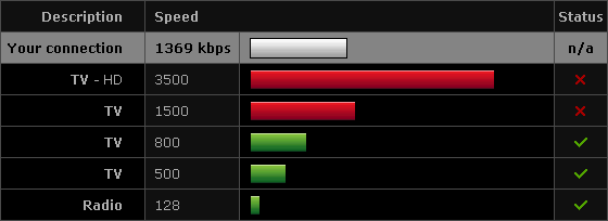

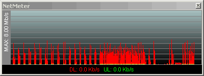

However, having now just looked around for any other useful data that I may have had lying around, I can see exactly what was going here.  Fortunately so can you as well because you do actually have all the relevant ethereal data to hand for around 2200 hours as well as for around 2300 hours !
The BBC/iplayer traffic at around 2200 hours - i.e. that to local ports 1200(ish) - was primarily an iplayer diagnostic test that was conducted around 1 hour prior to the iplayer streaming data test that involved traffic to local ports 1300(ish).  There was certainly very little going on in the way of any other traffic of any other kind in between these times or indeed for most of the evening.  My comments posted in this thread several hours later state that iplayer wasn't working sensibly all evening and general web access was also pretty dire all evening as well which explains precisely why there was nothing much going on other than the occasional test of one form or another. You already have the ethereal capture for both of these tests in addition to a typical netmeter graph and speed test results etc. at around the same times.  My service was virtually unusable all evening on 13/05/2012 as opposed to just being inexplicably bad.
The "iplayer diagnostic peak time rate limited" ethereal capture clearly shows the ports you are questioning being used for iplayer related traffic and being tagged $60. This capture also contains a block of iplayer data for one of the individual tests being incorrectly tagged as $60 as well of course.
The "iplayer problem 13-05-2012" ethereal capture is the streaming data test conducted mostly out of morbid curiosity around 1 hour later. This capture also clearly shows the streaming data being incorrectly tagged as $60 as well.  Needless to say the vid wouldn't play at all with such a major restriction in transfer rate.
My post made several hours later in this thread (HERE) contains a netmeter graph showing typical transfer rates for web and iplayer data from sometime around 2300 hours.  The iplayer streaming data is most likely to be the exactly same iplayer streaming data for which you have the ethereal capture. Data transfer rates are clearly quite poor in general but the iplayer data stream in particular is obviously completely wrong and totally unusable.  The speed test results also included in this post show general rate-limiting in place for the entire peak-time period.
Please note, however, that I think it would be very wrong to jump to a conclusion that iplayer streaming data tagged with $60 and a connection apparently rate-limited to 2Mb/s were both symptoms of exactly the same thing and are therefore directly related. Rate-limiting had clearly been seen on many days but incorrectly tagged iplayer data had not been obvious at the same time. There is definitely no indication that it had been consistently present at the same time that's for sure. In fact there is actually various evidence of iplayer streaming data being correctly tagged $80 although still being problematic of course due to rate-limiting and the related issues that caused of course.
I suspect (but have no hard evidence to support it) that iplayer data was being intermittently tagged $60 at various times (not necessarily just during peak-time or when rate-limiting in general was in place either) but it most definitely wasn't happening all the time.  The 13/05/2012 was quite clearly a *very* bad day, significantly worse than all other days, but intermittent problems had clearly been present to a generally speaking lesser extent for absolutely ages. It's very obvious when iplayer data is just "not quite right" from a quick look at netmeter even when it's sort-of playing reasonably well despite apparent bandwidth issues. In general though, there's always a massive difference in the graph when traffic is being incorrectly tagged. There's always a significant difference when iplayer traffic is just not quite right as well. Same thing with 4oD et al. It's usually pretty obvious to see when something just isn't as it should be even if it's not possible to see why.
I think it's important to note that all the file dates/times appear to stack up almost perfectly with the dates/times in the access logs. There are 3 different PCs and several different applications and lots of my very own fingers involved here ! They can't all be wrong in some major way but still come up with much the same date/time stamps for much the same data.  The ethereal timestamps may well be completely screwed up but it's pretty clear exactly when the captures were made and exactly what was going on at the time. It's just the timing of individual packets that is somewhat less than correct or in any way clear in ethereal although that could perhaps be established if it would help in some way. It would certainly be possible to establish when each of the various local ports were opened and subsequently closed if nothing else. It would also be possible to confirm gateway and all relevant connection stats at the time as well of course.
I've not seen any incorrectly tagged data at all recently.  In fact the only time that I have been able to find data tagged as $60 was by visiting the rapidshare site itself.  Even data for the home page of the site is tagged $60 never mind any random files being served by rapidshare. I've just not seen $60 data at any other time or place whenever I've been out looking for it. I've also not been seeing HTTP iplayer data much if at all recently either. Virtually everything is RTMP and is coming in at (or at least reasonably close to) the maximum available rate. There is absolutely no evidence or even any reasonable suspicion to suggest that iplayer RTMP data from anywhere was ever being screwed up in a major and identifiable way. Such data might not have been streaming particularly well or even playing that well at the time either but there was never any proof of something definately very wrong ... just lots of indications of something not quite right !  It has always been HTTP data and HTTP data from Akamai servers in particular that has been exceptionally problematic in a variety of ways, including being tagged $60 rather than $80.
With virtually no HTTP streaming data being seen, it is highly unlikely that any significant problems will be found or at least no useful evidence will be obtained even if whatever was going on to cause the problems being experienced is still going on today.  Does anyone have any suggestions for how I can somehow force iplayer to stream in HTTP ? I've tried a few things in an attempt to persuade it to use HTTP but all I seem to achieve is stopping it from working at all or it continues to stream in RTMP.  Clicking on "lower bandwidth" doesn't seem to do much if anything but then again it does say lower bandwidth IF available and all that.
As I said a while back, I'm kinda convinced that it was a combination of things causing the problems and I suspect that it was all being kicked off by low bandwidth in general. Low bandwidth probably leads to HTTP data being used and relatively poor quality playback.  Some HTTP data from some sources was then intermittently being tagged incorrectly leading to even lower bandwidth, even more problems with playback and ultimately resulted in iplayer giving up completely. The one thing that's very apparent the whole time is unexplained bandwidth restrictions various but most often, no real consistency either.
