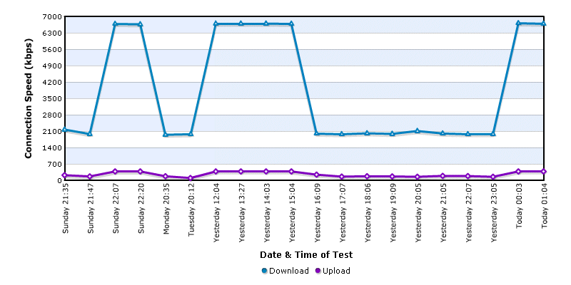

The latency/speed figures above were results from speedtest.net and all the gateway swaps and associated tests were done over a period of just a few minutes. In almost all cases, UL speed was between 0.1 and 0.2Mb/s so also ridiculously low and once again somewhat erratic.  On an ~8Mb/s connection with a consistent and quite intentionally very high SNR (~15dB) that is also consistently stable to within ~0.5dB with no significant number of  transmission errors, real-world DL should be ~7Mb and real-world UL ~0.4Mb
As can be seen, after ~10 attempts, I finally ended up with a gateway that provided something remotely close to what I should be getting and it allowed iplayer to stream reliably without major issues. In all other cases, performance was dire and packet loss (as indicated by a remote test running 24/7) was significant whenever attempting to stream data or make reasonable use of my connection but not otherwise. To all intents and purposes, data rate was being capped at ~2Mb/s on average but it was also going up and down like a fiddler's elbow so there were often long(ish) breaks or periods of near-zero rates stalling playback.
NEEDLESS TO SAY, everything returns to being almost exactly as expected at midnight so don't even think of suggesting that it's a problem with my equipment, setup, phone line or indeed anything else at my end of the wires because is quite clearly isn't !!!!!

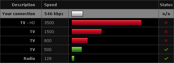

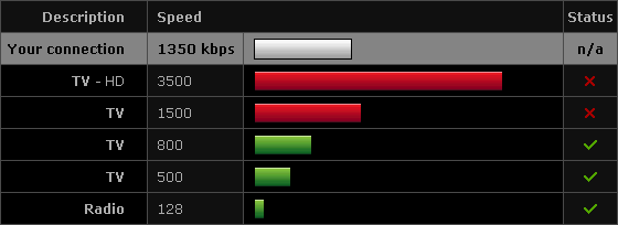

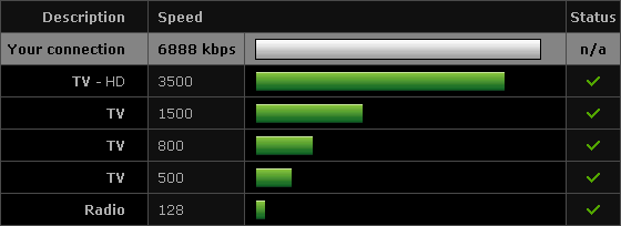

Just by way of a little demonstration of that fact, here's a typical iplayer diagnostic performed just prior to midnight this evening:
And here's the very same thing repeated less than a minute later at just after midnight:
Earlier in the evening the results were significantly worse than as shown above at just prior to midnight.  iplayer was pretty much unusable all evening (with a very erratic often sub 1Mb/s never mind sub 2Mb/s average data rate) as was just about anything involving streaming data such as 4oD, youtube, just about every advert on any website and especially anything involving Akamai servers of course.

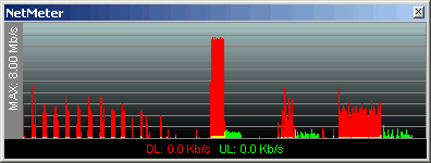

As further evidence, here's a typical netmeter graph from yesterday:
The initial data transfer shown is iplayer streaming data (or at least trying to) at somewhere around 2000 hours, then a BT speed test  (relatively low result at ~5.5Mb/s) then a couple of other speed tests (typical results ~2Mb/s) in an attempt to find out why streaming problems were being experienced. The only relatively good thing is that the iplayer data stream was on this particular occasion unusually consistent.  Until this most recent problem started and apart from during previous similar problems of course, iplayer data streams were almost without exception at or very close to maximum line speed.

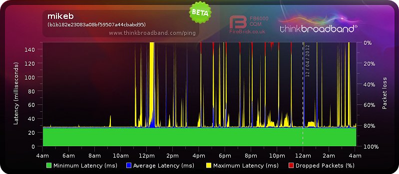

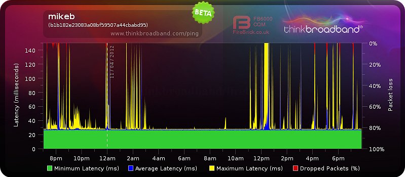

The packet loss graph:
clearly shows spikes every hour between 1600 and 2300 hours when I did the monitoring tests. The identical tests conducted between midday and 1500 hours and those after midnight caused no such spikes of course because the problems quite simply don't occur between midnight and 1600 hours.  The other period of packet loss at around 2130 was when trying to watch something on iplayer. There was no packet loss of course when watching the same thing immediately after midnight or indeed when doing anything else at any other time over the 24 hour period.

Tonight, however, it's a quite different story and iplayer really only wants to keep on showing me this after trying to play just about anything for a short while:
which is primarily because the data stream is looking something like this:
and iplayer diagnostics and speed tests various are looking something like this:
