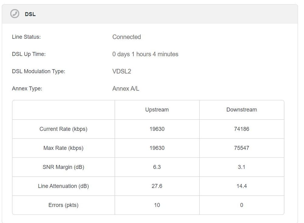

Hi,
I have uploaded an image on my DSL stats - The logs get reset each time I reboot, next time this happens I will be sure to save the log file first before re-booting the router

Thanks for that information. As the DSL uptime will reset on a reboot - an hour ago? - it is a little academic, but shows you have had to do it recently. One statistic on there which I would be querying is your D/S noise margin, but I suppose with the low attenuation, it should be OK.
The other 'interesting' figures are your connection speeds as reported - if you are losing connection on a regular basis, I would expect the 'current rate' to be lower. That, plus your noise margins, has got me a little confused, as I would expect DLM to raise the margin and reduce your speed in an attempt to stabilise your connection.

OK. As I said, the error logs may give us an idea, but your connection speed on that post looks very good.

It will be interesting to see the results of the stats if you get this slowing down on the wired PC. The current stats show that your downstream SNR is on the minimum limit. It may be that this is stuck and trying to support a line that can't support this level due to REIN on the line.

Having a downstream SNR margin of 3.1 and upstream SNR margin of 6.3 would suggest a great connection.
At 3.1, it looks like DLM is in control and isn't struggling, I can run mine down to 1.0 before problems occur.
