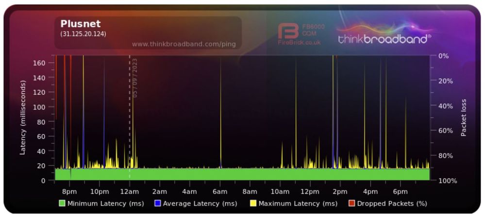

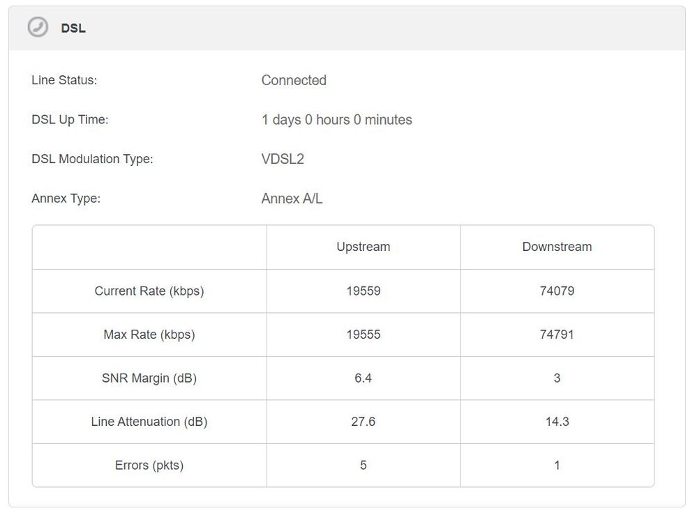

DerekW
Re: Poor Speeds And Dropouts
Message contains an image Message contains an attachment
@Dan_the_Van
We are at the 24 hour mark now, have attached images and log file.
Any thoughts?
"No one has ever become poor by giving" - Anne Frank
@DerekW
Looks like you changed the cable at around 13:20 and the DNS at 13:40 as the PPP connection restarted, which is what I'd expect.
So for 24 hours there has been no DSL disconnect.
I would leave any further change until the morning and put the faceplate back in circuit. With any luck taking it off and resetting may have cured any flacky connection.
However you are getting peaks in latency blue spikes, can you think what may be cause.?
HTH
Message contains a hyperlink
That'll be because @DerekW  hasn't fixed the bufferbloat !
