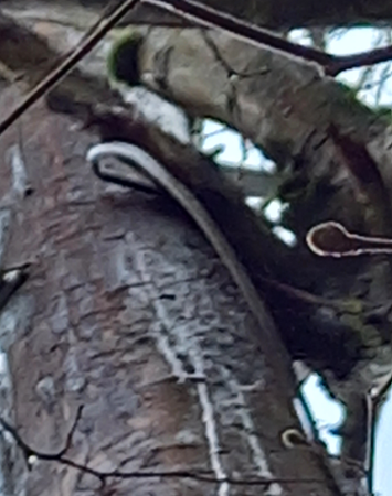

After months of experiencing poor or non-existing broadband and enough visiting Openreach engineers to form a rugby union team with several reserves, my patience was finally exhausted so I took a walk along the road near my house to see if there was anything obvious that might be affecting my service.
The attached photograph shows the state of the telephone cable that connects to my house, at the very first pole I checked in the road just outside my property.  After so many months and endless engineer visits, am I right to feel somewhat disappointed that this has not previously been noticed?

Which of the cables in that blurred picture connects to your property? Apart from the state of the pole itself - which looks unsafe to climb - I can't see any major issues.

Difficult taking photos vertically up a 30ft pole while standing on a sloping, very soggy grass verge.
There is only one cable on the pole, so I know it carries the phone & broadband services to my house.
The cable in question is currently well and truly trapped between a heavy, forked tree branch and the pole itself.  In windy weather the tree (and presumably the pole) have a tendency to move, applying both tensile and abrasive forces to the cable.  This may go some way to explaining why both telephone and/or broadband services fail each time there is a passing storm - of which there have been plenty of late.  This situation has been ongoing for years which is why I decided to investigate, and it does seem strange that after dozens of engineer visits this has not been noticed before.  If anyone would like to take a look for themselves (and perhaps try to take a better photo) the pole is located at grid reference SJ 06441 51493.

I have looked at the picture I see, post steps, branches and one cable trapped between a branch and post
Cable trapped between post and tree branchCable trapped between post and tree branch

@rolosatinlace all that ISP's can do is to raise a fault to Openreach. If your broadband is still faulty, then raise another fault with Plusnet. When the Openreach engineer attends then point out the cable problem on the pole.  Whilst you could point out the cable issue to PN and they can add it to the fault, its likely that the information doesnt get passed to the OR engineers.
Alternatively you could try reporting the cable damage directly to Openreach https://www.openreach.com/help-and-support/damage-health-and-safety

You need to get Plusnet to arrange for Openreach to remove the branch - I am surprised that you have not mentioned this to visiting engineers, or that they have not seen it - I can't believe all of them are incapable of spotting the issue.
