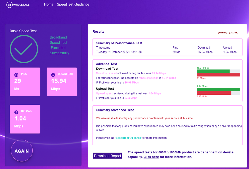

Here's a thing - this afternoon I took the front off the master phone socket to check if there was a test socket, discovered with the front off there was no internet connection, so put the front back on, maybe a little tighter than before. And suddenly the ping response times were less than half what they were typically before.Here is the BTW speed test - this is before plugging directly into the test socket:

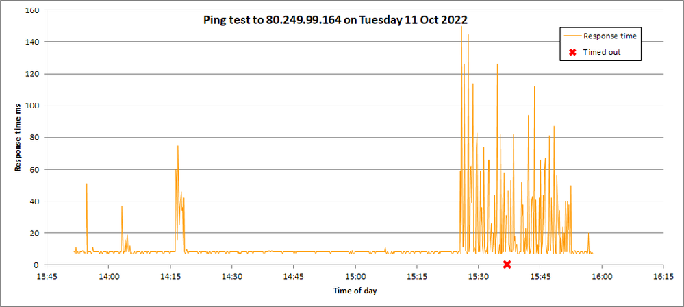

I did a two hour repeated ping test with the Hub One plugged directly into the test socket with a wired connection to a pc which showed mostly really good responses but a very erratic responses for a 25min period:

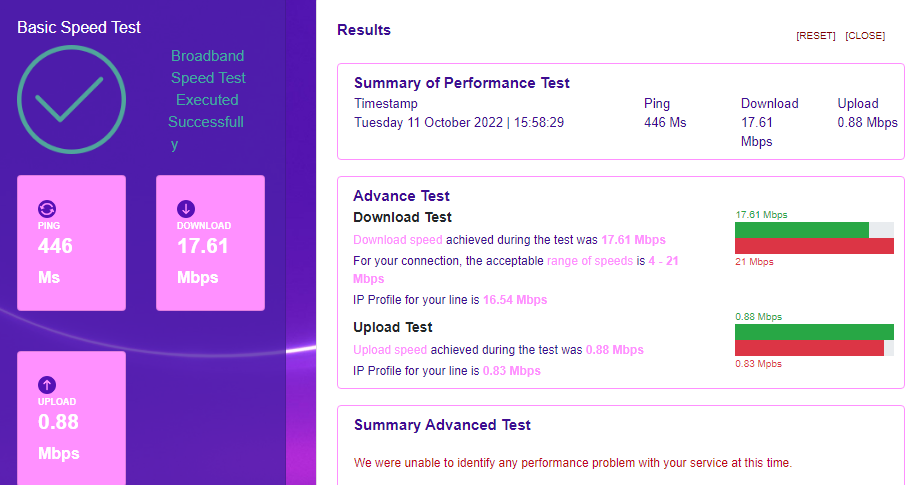

Here are the BTW speed test results from the beginning and end of this long test period:
And at the end:

I don't know if that means part of the problem was at our master socket all along. I don't think the master socket has been touched for 10-15 years or so. There is still the issue of the 25 minute period with erratic ping response times. Do you think there is still something that needs to be investigated?

I hope it stays like this also! What do you make of the section of the latest ping test where the response times were suddenly erratic and really long?
Re: Plusnet broadband unlimited keeps dropping out this afternoon
11-10-2022 7:02 PM
To be honest, Simon, ping times are something I have never had to worry about, so they are not something I have investigated and have little knowledge of. I do see odd bursts on my my TBB graph, but they have never interfered with my browsing, so I ignore them, TBH.Maybe other Community members ( @Dan_the_Van , @RealAleMadrid - any thoughts?).
