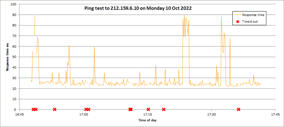

Attached is a log from last night showing results of pinging the plusnet DNS every 10 secs over about a 40 minute period.
Simon

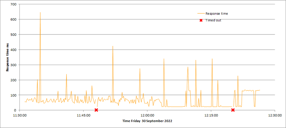

Here is a rather long reply:

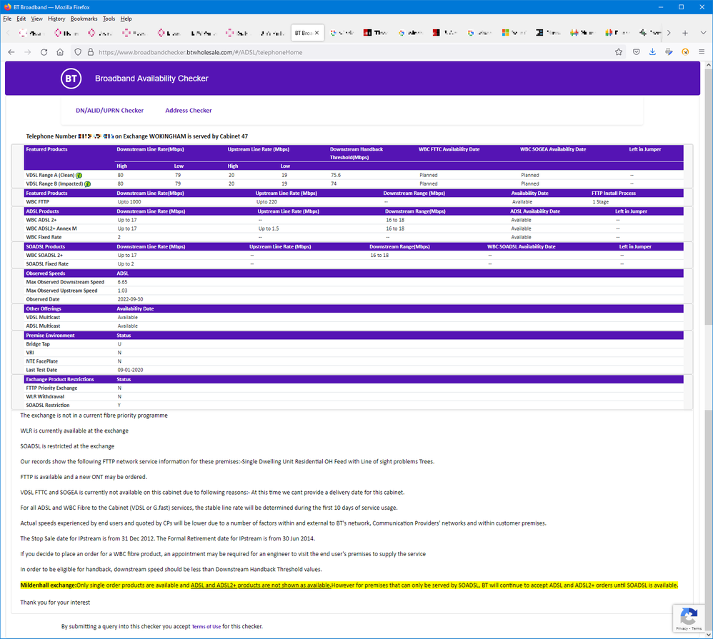

The line seems to have remained up for several hours up to now, but you can see from this graph of ping response time that the speed is all over the place:
Screenshot from Broadband Availability Checker:

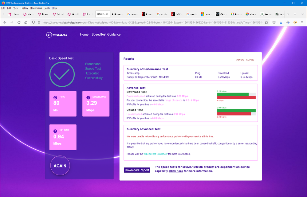

Screenshot BTW Performance Tester:

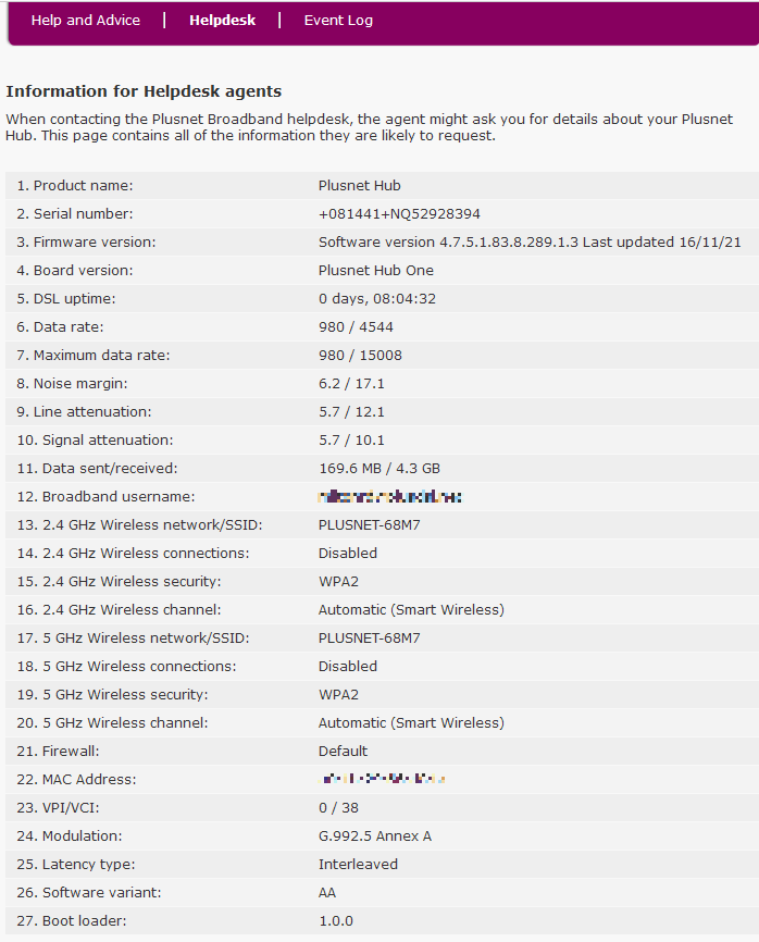

Screenshot from Hub One Helpdesk Information:

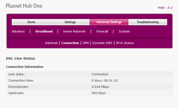

Hub One connection status at about 1145 today:

Posts: 22,708
Thanks: 7,928
Fixes: 334
Re: Plusnet broadband unlimited keeps dropping out this afternoon
@simonc2 Thanks for that detail - very comprehensive. Based on that, I suggest that you raise a Broadband error report via: https://www.plus.net/help/report-a-problem/broadband/, as your connection should be giving you much higher speeds, based on the BTW report. Your highly elevated D/S SNR points to a fault somewhere in the network, which Openreach need to investigate and resolve.

@simonc2  You appear to be on an ADSL2+ service, is that sufficient in terms of speed because it doesn't look reliable at all.
The checker shows that you have both FTTC and FTTP available. The FTTC speeds show the maximum speed of 80Mbps so you must be quite close to the fibre cabinet. I have 80Mbps FTTC and have not had any dropouts or speed reductions since getting it nearly 3 years ago so very reliable. FTTP is fibre to the home so even more reliable and with much higher speeds up to 1000Mbps if you want, but lower speed packages are available and cheaper.
You should consider upgrading to a better service.

Thanks for your reply. I've raised the fault report.
Where in my reply did you find the information about D/S SNR? I assume SNR is signal-to-noise ratio? Not sure what D/S means.
Simon
Posts: 22,708
Thanks: 7,928
Fixes: 334
Simon
Line 8 of the Helpdesk shot, D/S is Downstream, and you are correct about SNR. Please let us know the result of your report.

Update on my broadband line: I reported the fault to plusnet last week and they have now sent a message to say the problem is fixed. I attach the edited correspondence which will mean more to you than it does to me. However, the response times are still very unstable - see the attached graph showing results from pinging every 10 secs for approx 1hour today - and the noise levels are showing as
8. Noise margin: 6.2 / 14.9
Is this acceptable or should I be pursuing this further?
