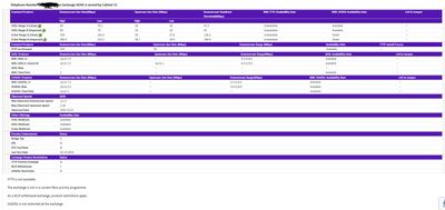

If the post a screen image of the results from the following (after hiding personal details) it may help Members provide advice. Include the narrative below the results window.

Results show:

On PN ADSL the line appears to be eligible for transfer to SOADSL which is an internet only product if they're not interested in higher speeds from FTTC. Given the ADSL pricing nowadays there might not be much difference in price.
