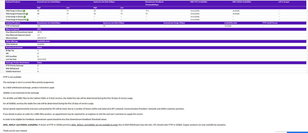

@stockfast  can you put your MIL's phone number in to this - https://www.broadbandchecker.btwholesale.com/#/ADSL
Take a screenshot from "Featured Products" down to the bottom of the page (being careful not to include the phone number or address at the top of the screen).  Then post here the screenshot image file using the 'Insert Photos' button above the forum edit window.

Posts: 5,805
Thanks: 2,152
Fixes: 116
Re: Plusnet Hub 2 ADSL no internet
@stockfast
Are you sure you're on ADSL? The screenshot suggests VDSL (FTTC) is available.
Posts: 24,891
Thanks: 8,926
Fixes: 382
@bmc It is definitely an ADSL connection - see the 'Observed speeds' field.
outcast
Aspiring Champion
Posts: 961
Thanks: 393
Fixes: 19
Registered: ‎11-01-2025
@bmc  the screenshot also shows the "Observed Speeds" for ADSL

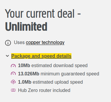

stockfast
Posts: 18
Thanks: 4
Registered: ‎13-02-2025
As far as I know it is. This is what Plusnet shows.
