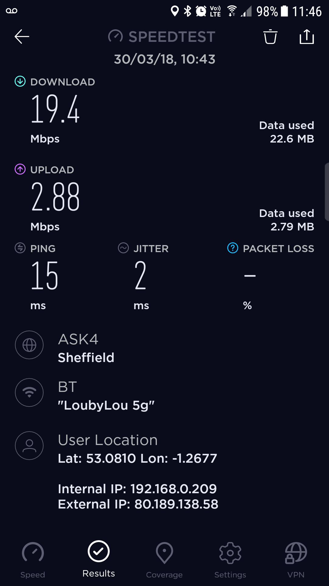

I have tested over a wired connection and it's the same result. I also ensured nothing was connected to my network when performing the tests and also tried a different router. For the record and as I keep staring my ping was 16ms constantly from August last year on both wired and wireless connection. I don't use wireless for gaming and only used the screen shot as an example of the ping increase. I have attached another screen shot of a test I carried out in March, again on wireless to show what my ping used to be and what it always was until recently. I would like to know how it can be low for 7 month's then just double without explanation. If it is interleaving why would it take 7 months to decide I have errors on my line. If it isn't interleaving then what is causing it. I always carry out my ping test with nothing connected to the network and my router plugs directly into a new type master socket with the filter built in.
