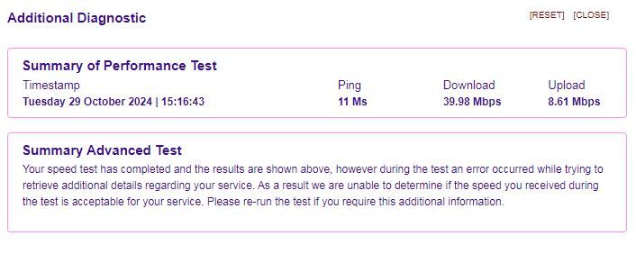

Hi,
It seems to be a regular problem, but once again I have experienced a couple of outages of my broadband and now I am getting slower speeds (from 50Mb+ to less then 40Mb).
Please see HERE for the previous time this happened.
If anyone is able to test my line and/or provide any help/next steps it would be much appreciated. I would really like these problems to be solved.
Many thanks in advance.

Looking at that data, I have a couple of observations. Unless you have intentionally disconnected, there is a fault, most likely in the Openreach network - your DSL uptime is only a couple of hours. With an attenuation such as yours, a 2.9dB noise margin is going to give rise to problems if you get any spikes/interference on the line.
I suggest the following:
If the phone test passes, report a broadband problem via: https://www.plus.net/help/report-a-problem/broadband/
The above assumes you still have 'normal' landline connection - if you have a SOGEA (internet only) one the only option is to call Plusnet - 0330 123 9123
