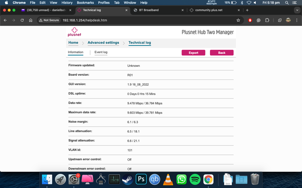

Rang plusnet Monday and someone reset my line (not sure what exactly) and speeds went up from a capped 35.999 to this.
Much better sync speed, but not quite hitting the mark.

After the line change i'm left with an even slower sync speed (especially my upload) and a ping ms thats doubled from 18 to 40ms.
Any ideas where the problem could lie? DSLAM? DLM? Banding?

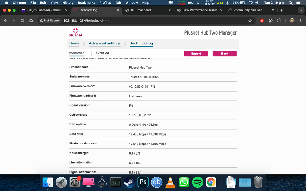

Starting to think there's an issue with the Dslam as it's coming into the cab at 78Mb and by the time it's at the next drop point it's at 36Mb.. Total line is 600m from cab.
Lines have all been swapped from the cab to the house, only made things worse.
Plusnet have reset the ports in the cab today as well, better upload sync, better ping but slower download sync.

This has echoes of markedly bad D-side segments. In such situations the best that you might get, is the best of a bad bunch. In some areas the D-side segments are in poor condition, in need of replacement ... which as the roll out of FTTP progresses is highly unlikely to happen.
The fact that a marked drop has been measured part way along the D-side firmly points to a cabling issue. That makes me wonder if the segment is copper or aluminium!! I had a mixed metal D-sides years ago ... in the end, they re-routed the O/H via a different pole to 'avoid' the aluminium segment.

Getting 43Mb down 14Mb up now, but line drops every day or so.. Keeping an eye on it, might be the DLM doing it's thing.
