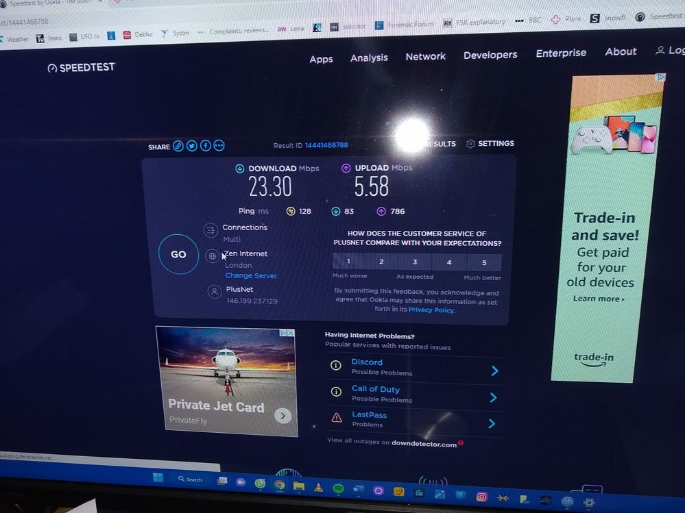

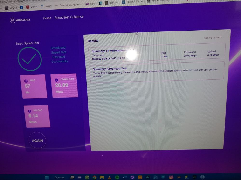

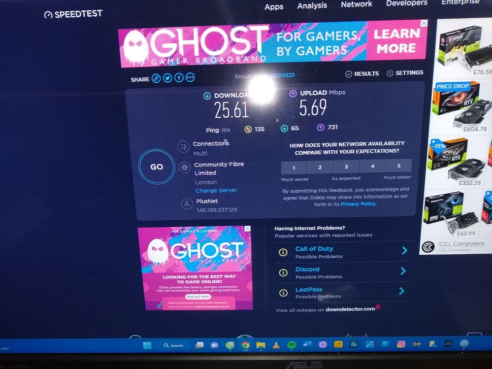

BT speed with cable .jpgBT speed with wifi.jpgBT Test.jpgOokla speed with cable.jpgHere areOokla speed with wifi.jpg
Image 1 is BT speed using a cable
Image 2 is BT speed using wifi
Image 3 is BT wholesale
Image 4 Ookla speed using cable
image 5 is Ookla using wifi
The noise test produced silence.
I can't produce the router page becuase I a using a different router than the one supplied.
What seems to emerge is that Ookla always reports a lower speed figure than BT, and that cable makes big difference.
On the BT wholesale page it says FTTP not available. So I checked the Vodafone website and my adress says full fibre *is* available. So I phoned and queried all this, and they checked again, and they confirmed they could offer full fibre. Can anyone make sense of this?
