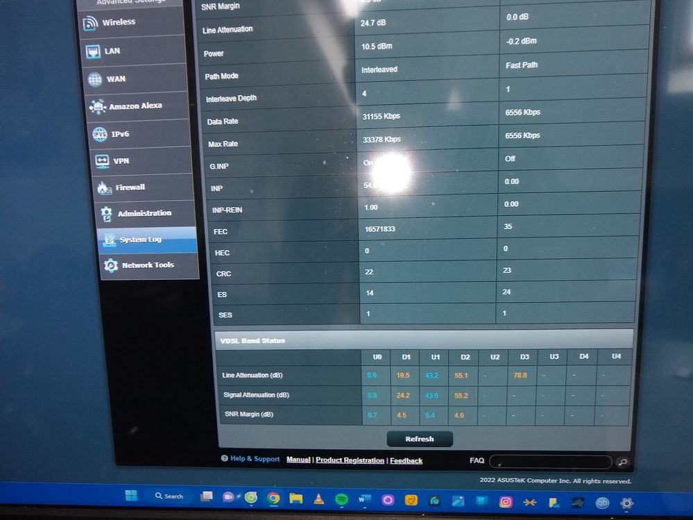

- You'll find the information required on the System Log->DSL log tab.

Re: Not what I had hoped for by a mile
07-03-2023 10:33 AM
Hi,
Thanks for sussing ou the right page.
The router page is long so it is presented here in two shots that overlap.
Best
A
07-03-2023 10:41 AM
@amutimer Two things stand out in those pictures (1) Your DSL uptime is very short - have you done a reset lately? (2) Your downstream SNR margin looks a little low, which may or may not be helping.

07-03-2023 11:26 AM
Can we clear where you now want to take this. Do you want to continue with your complaint that Plusnet should know what other operators are doing in your street? If so, see https://www.plus.net/help/legal/complaints-code-of-practice/.
And/or, are you seeking help with getting the best out of that which Plusnet is supplying? If so, are you prepared to follow some simple DIY tests?
If the latter then first check that you have a quiet phone line by plugging in a wired phone and ringing 17070 then option 2. If there's any noise on the line then you need to report a phone fault and get that fixed as it will slow your connection.
If that is OK then remove the front section of your BT master socket, this will either be clipped on or held on with two screws. In behind you will find the Test socket. Plug a microfilter in there, connect your router to this and report the speed that you get and any changes to the results that you posted here: https://community.plus.net/t5/Broadband/Not-what-I-had-hoped-for-by-a-mile/m-p/1912711#M355740.
