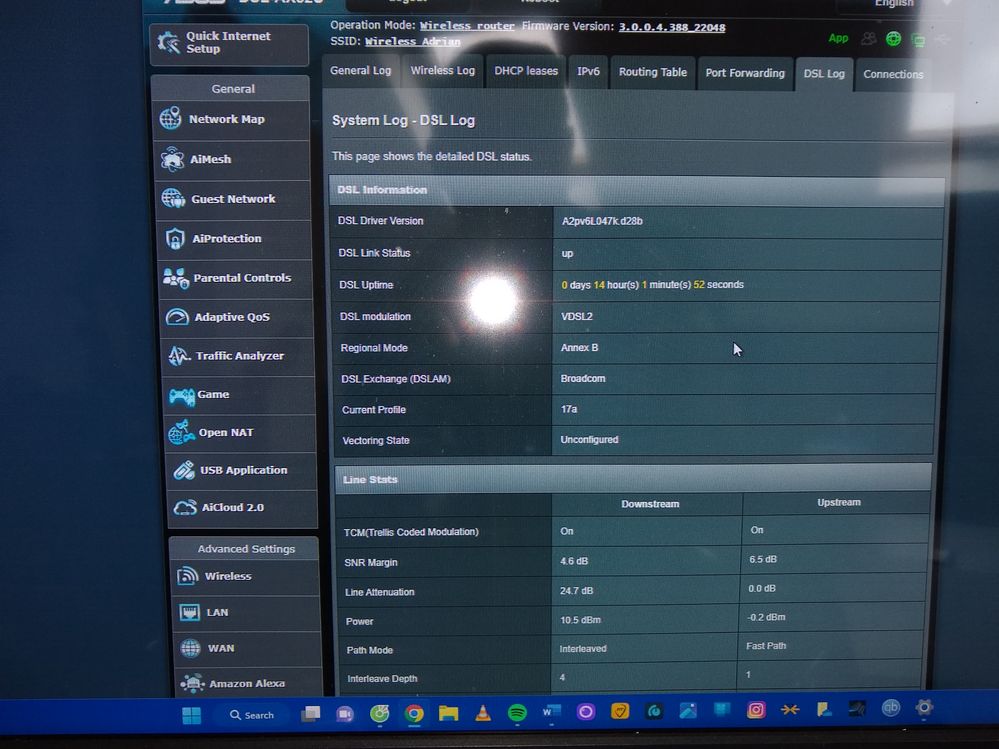

  1. You'll find the information required on the System Log->DSL log tab.

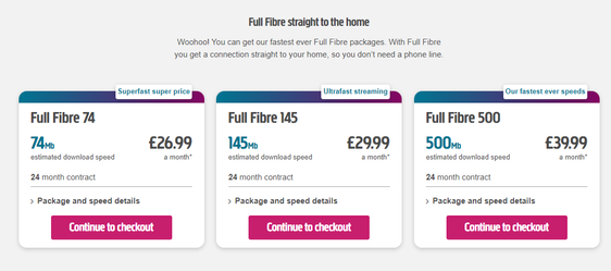

I now consider I made a massive mistake when I put the order with Plusnet. But it is their fault too. They do not make it clear that they do not use the fibre cable down the street. If they had, I would not be with them.
Perhaps you have made a mistake when you places the order, but I fail to see how it is plusnet fault as if you ordered online using your postcode and house number you would have seen this for a full fibre locationScreenshot 2023-03-07 075428.png

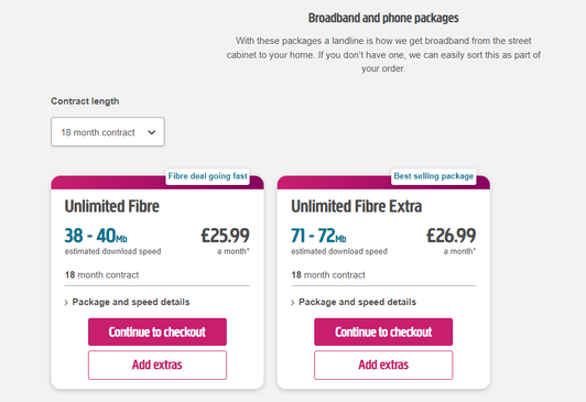

for a FTTC location.
Regardless of speaking or ordering online the welcome email from plusnet would have confirmed your order and it would have detailed your expect bill and the package, the email should have detailed when the 14 day notice period starts.

The router page is long so it is presented here in two shots that oIMG_20230307_102755793.jpgIMG_20230307_102745302.jpgverlap.

@amutimer Two things stand out in those pictures (1) Your DSL uptime is very short - have you done a reset lately? (2) Your downstream SNR margin looks a little low, which may or may not be helping.
