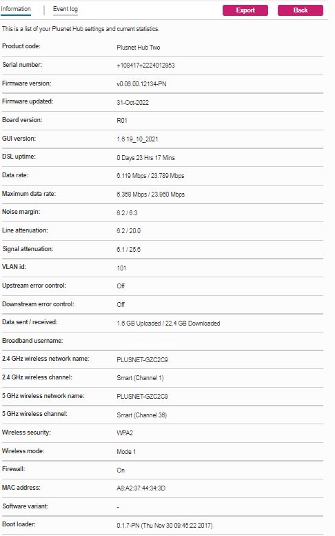

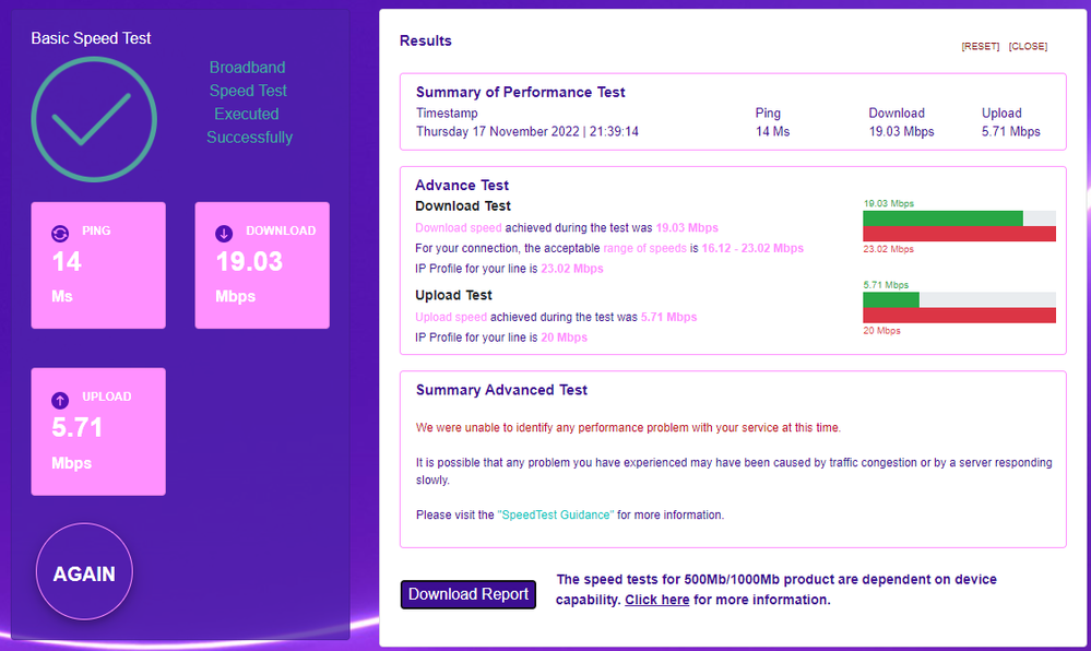

BT Broadband(obscuring your phone number) and BTW Performance Tester - Over a wired (Ethernet) connection if at all possible, please report the 'ADDITIONAL DIAGNOSTICS', and sight of the broadband connection status from your Hub (with the 'Username' obscured) would be a good starting point.

Hello John,
Here are the details requested.
Please let me know if you need anything else.
Many Thanks,
Dylan.

I don't need anything else, thanks. The BTW report and your Help Desk tell me all I need to know - you have a fault on the BT/OR network. Report it via: https://www.plus.net/help/report-a-problem/broadband/
It should get picked up sometime tomorrow morning. Please let us know the response.

I suspect it is more than crosstalk, Dylan. Unless you habitually turn your Hub off, your xDSL uptime, and horrible low IP profile points more to a failure somewhere in the BT/OR network.
