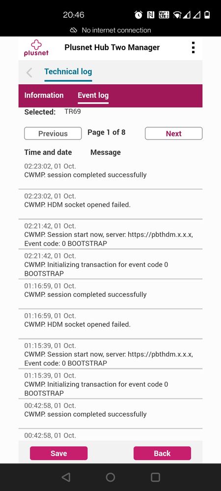

There is no way of setting up the time/date, I'm worried you are seeing NTP errors as with the Hub Two I would expect the time to be correct. Are you seeing TR69/CWMP errors as well?

In relation to the TR69/CWMP errors, please see screenshot of first page log. (Sorry if it's a bit big, I'm on a mobile device which doesn't seem to size appropriately)
