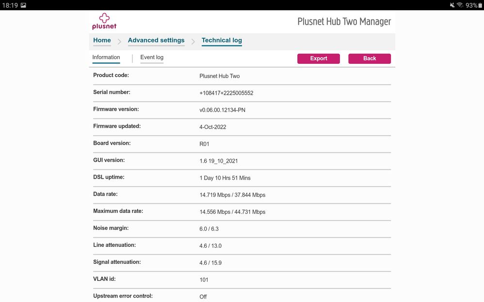

Moved into a new house, signed up for plusnet fibre extra. Was advised i should be able to get 68 - 72Mbps, but so far a little over a week into the connection going live i am only ever seeing 32 -34 mbps down. Logged onto the router page and can see its only syncing at 37 which i thought was odd. Could this indicate a banding issue?.
Connection type:
Fibre Broadband (VDSL)
Downstream sync speed:
37.844 Mbps
Upstream sync speed:
14.719 Mbps

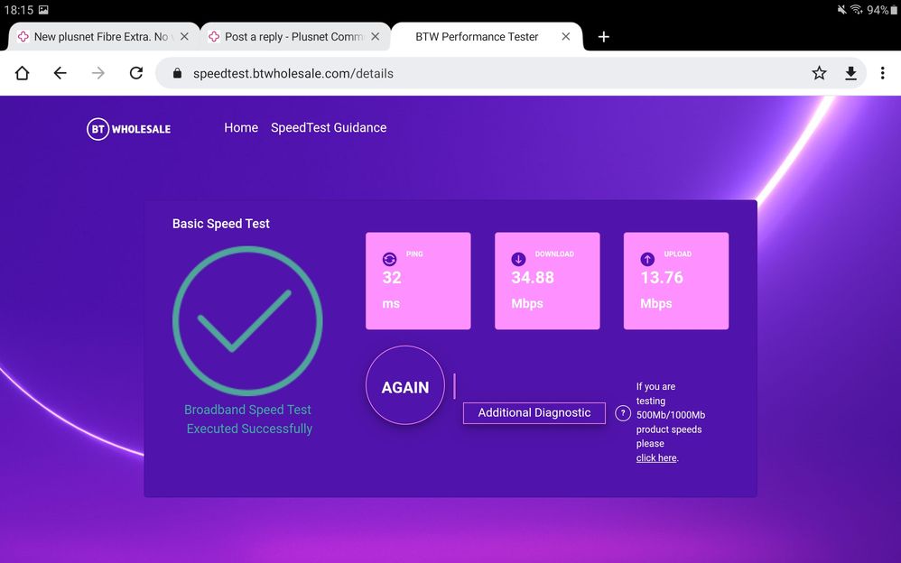

Tried my laptop via ethernet direct to the router with much the same results. Also did the openreach speedtest from the router page, i never seem to get past 34Mbps no matter which way i test.

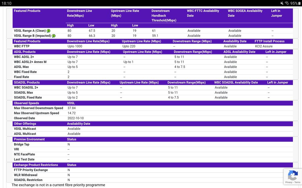

BT Broadband checker:
BTW Performance tester:
Technical log:
It was easier for me to do this from my tablet, but i also went and did a speed test from my windows laptop by ethernet with the same results. Still never seem to break the 34Mbps barrier. By comparison i just tethered my tablet to my mobile which is on three 4g unlimited and that returned a download speed of 96.3Mbps. That actually surprised me! Lol.
Something certainly doesnt seem right with my plusnet speed though, so i hope i can get that where its meant to be or at least above 60 which i think was the guaranteed minimum.

Thanks for those screenshots , Bill. Something certainly isn't correct - you are on Fibre Extra (80/20) according to (a) what you say and (b) the BT Broadband checker, but for some strange reason, you downstream speed is way below what it should be - actually below the Handback Threshold.
Just out of interest, could you run the speedtest again, but this time, run the 'Additional Diagnostic' and post back.
I note from the Hub technical log that your uptime is very short - unless you are intentionally unplugging/switching off the Hub, that is a fairly clear indication that you are losing DSL sync, which need Openreach investigation - please run : https://www.plus.net/help/report-a-problem/broadband/ and let us know the outcome - it should suggest and instigate the OR investigation.
