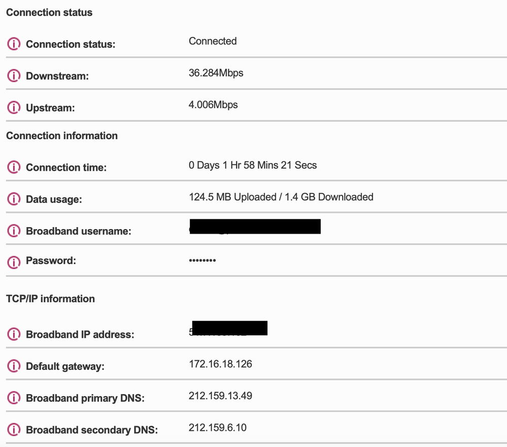

Here's the full broadband info, although there's not much extra info other than the gateway and DNS info.
Are you reading the correct upload/download?. I don't think an upload of 112Mb would classify as "massive" these days 🙂

@EddieR
Which package have you signed up for 'Fibre' ? It looks more like Unlimited Fibre 40/10
