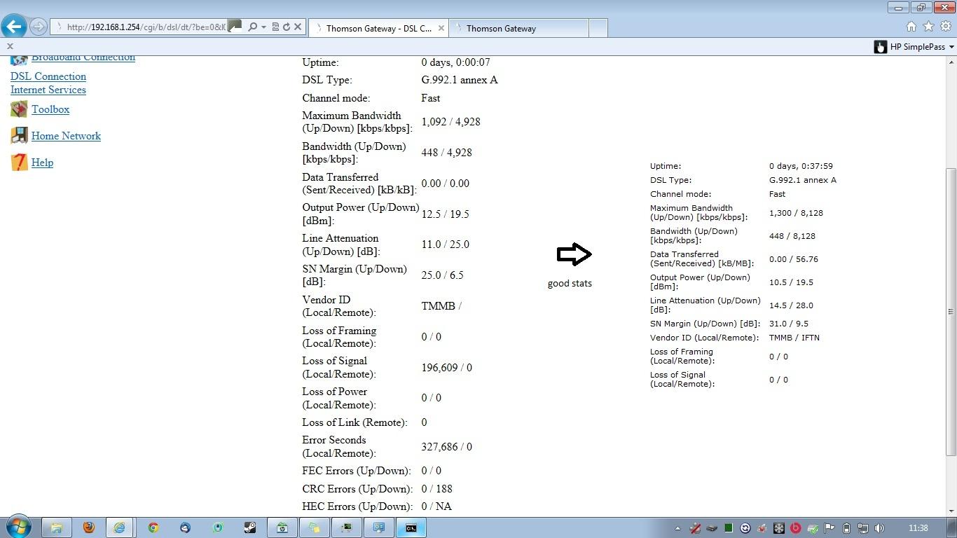

EDIT. done the diagnostics.  Our neighbour has extension sockets but no master socket that I could find (just an oval junction box where the line comes into the house).
Here's the router stats.
BAD stats on the left GOOD on the right
Atten and S/N margin don't look that bad (do they?)  Lots of errors though.

Are the stats from your neighbors connection?
There's certainly a big difference in the stats you have posted.

Hi - yes that stats on the left are from our neighbours (well, half a mile away) new Plusnet connection.  I don't think the Atten and S/N margins are THAT different from ours but they're getting tons of errors.
Tech support has switched interleaving on.  Is this a good plan?  Thanks for your time. I will PM you my neigbours details and you will see what is being done. cheers.
