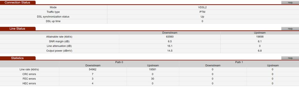

Just an update,
I've had a few drops in the last week and had an engineer out yesterday. He seems to have been able to up my line speed nearly 10mb by changing a pair in the cabinet? The attainable speed is now about 63.5mb but my actual speed is still stuck at the lower speed (54mb) I was at before the engineer. Am I restricted to this lower speed for a reason, I read something about banding?
Really happy he was able to get it up that much, but don't seem to be able to now get the actual speed to match the attainable
Thanks in advance.

@Stoneblade The attainable rate in the modem stats is not a real achievable speed it is a calculated value that the modem generates using an algorithm in the firmware that is often hopelessly inaccurate, sometimes it may be close to your actual speed more by luck than anything else. or as you have found, much higher than the actual sync speed, this is commonly the case when interleaving is enabled. There are many line conditions that affect the sync speed which the attainable calculation cannot cope with, such as in my case for a known reason I am running at a very low SNRM value of 1.8db at full 79.999Mbps sync speed, my attainable is 74.508Mbps so it is rather low. My advice is to ignore the so called attainable and concentrate on the actual sync speed.😊
Edit: Your line profile is in no way related to the attainable speed figure.

I can see the DLM profile is "Downstream: 0.128M-80M with Interleaving (Low). Upstream: 0.128M-20M with no error protection" so there's nothing restricting your modem from negotiating a higher sync speed to the cabinet.
It also looks like your speed has crept up to around 62mbps today. ![]()

Thanks for the update, I swapped out the modem for a BT Home 5 Type A this morning which seem to bring the sync up to speed. I did have to reset the hub a couple of times which dropped my sync by a couple of Mb, hopefully now the line is stable it will regain those lost Mb?
Thanks for the others advice too. I am a bit of a beginner with all this and appreciate the feedback.
