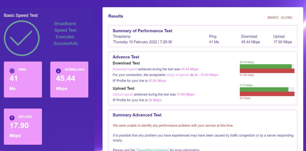

6. Go to the Hub Broadband Performance Test page and following the instructions run a speed test and report back.
7. If the speed is less than 43Mbps then continue to the further diagnostics and report the results. This will  record the results for use by Plusnet/Openreach. In this case leave your setup connected to the test socket until it has been checked out by Plusnet.

Did your steps this morning, no noise on the line from what I can hear (I don't have a wired  phone).  On going through the socket itself the line went up by about 0.2mb but wondering if that's from another reset? I also changed the modem cable with the one provided (I have a thicker one I normally use) I am downloading at 45.4mb/s I'm still about 10mb off what I used to get when I first signed up and about 5mb off what I was getting with the original router. As its above the min speed from Plusnet there is nothing I can do?  Its just odd within the 3 years of living here it has gone from 65mb down to this speed and no one knows the issues.  We do live in a block of flats (6 flats), I think all residents in the flats have seen the speeds drop over time.  Everyone in the houses on the street get the full speeds of 75mb.

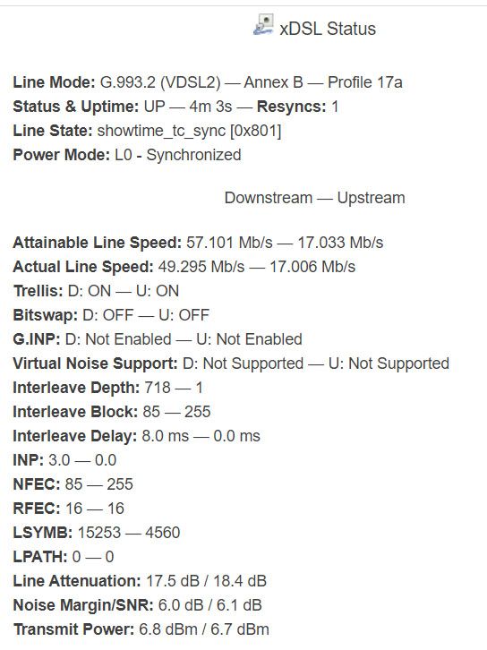

Openreach engineer has been and switched "line pairs" or something and reset the DLM.  My max attainable sync speed is now 57mb which is alot more than it was before, but my actual speed seems to be stuck on the lower 49mb, is this correct?  Or is it meant to be close to the max?  I have gone back to my old hardware for a second as its easier to see line stats also a better connection, and have attached a picture of what it is seeing.
