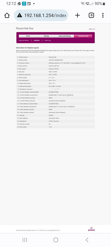

Hi sorry about that a few problems uploading. Hub Tech Log. There's an extension from master socket to bedroom to study. Appreciate any help as speeds still the same. Thx

Based on that extremely difficult to read Help desk shot, I personally think there is more going off - low DSL uptime, high D/S SNR margin both lead me to suspect outside problems, although the xDSL uptime could be a red herring if the OP has benn swapping cables/disconnecting.

Hi hub shot is clear just when uploaded?
