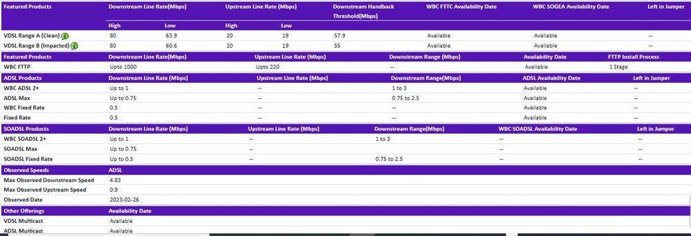

I`ve done a `snip` as advised and reduced the size of the image to hide my phone number.

With those estimates you should easily get the maximum speeds on Unlimited Fibre, that is 40 Mb down and 10Mb up.
You also have FTTP available but plusnet are not offering a phone service with that.

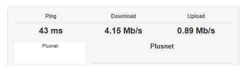

I`ve also done a fresh speed test today on my existing ADSL which are speeds that have been stable thus far. Upgrading to fibre estimated speeds of around 38-40mb should (hope!) may mitigate what I was being offered had I stayed on ADSL of roughly 1-2mb.
I`ll let you guys have a look at the page above and determine what that means I have no idea.

The BT figures for ADSL are abysmal.
To judge if you are getting the best from ADSL, we would need to see the router stats, after checking the quality of the phone line. (Note a faulty phone line is likely to impact FTTC performance as much as ADSL.)
Broadband is not going to work well if the "phone" line is not working properly.
Please perform a quiet line test - dial 17070 select option 2 using a phone plugged into the test socket behind the face plate of the master socket (ideally this should be a corded phone). The line should be silent. A noisy phone line (or no dial tone) will have a marked adverse impact on the performance of broadband.

Unless of course his abysmal ADSL speed is due to a fault on his d-side circuit which will equally blight his FTTC service. We have seen several users hop to FTTC only to find that does not meet expectations either. Sadly only after an upgrade and new contract tie in has the right action been taken to investigate why performance was so poor.
It might well be the case that the line is too long for decent ADSL, but we have not seen evidence one way or another.
