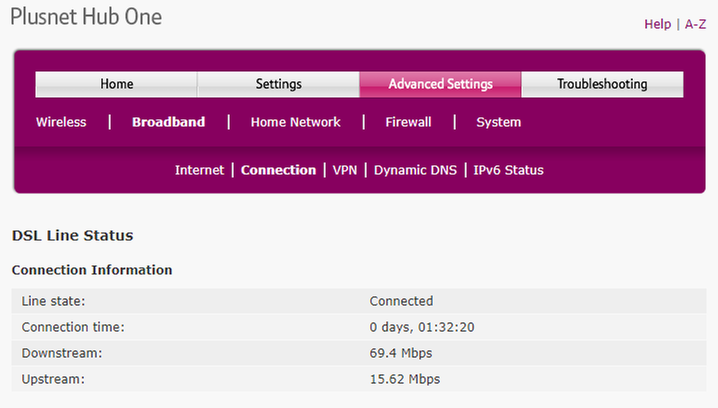

OK.If it is a Hub1, what about this page:

Trying to post an image, but it doesn’t like me. The screen reads:
Line State: Connected
connection time: 0 Days and 11 minutes (just tried another reset)
Downstream: 55mbps
Upstream: 14.99mbps
Re: Nearly 6 Weeks without a working service
06-08-2023 4:45 PM
OK. So you have a working connection, as demonstrated there. Forgive the multiple questions here, but I'm just trying to see if I can spot something you can take back to PN and say 'this is what needs sorting'.
If you have a blue light, your username and password correct, what does it say on the 'Settings'>'broadband' page?

06-08-2023 4:52 PM
What about the Connect/Disconnect button to the right of that statement?
06-08-2023 4:52 PM
Actually connected just means you have a DSL connection, you need to check the Internet tab as that will display if there is one
It should look something like this.
06-08-2023 4:56 PM
OK - so you are connected. What does the page posted by @Dan_the_Van look like?
