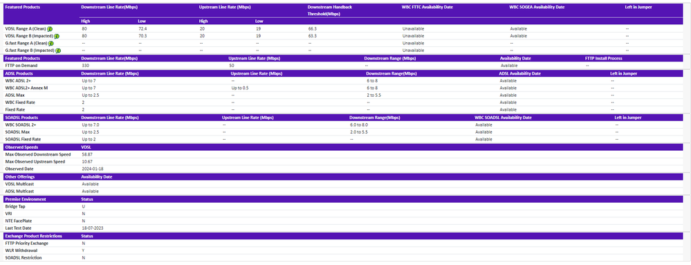

I've also provided the broadband availability checker results below:
Going by the stats then does there seem to be a reason why my speeds have dropped, and is there anything i can get plus.net to do to resolve. Talking to them on the phone last time didn't get anywhere - all they said was that my master socket looked old. I think it's a MK3 VDSL faceplate.

Which Router are you using with the HG612?
From the BTW checker you have provided, your speed is below the Handback threshold, so you have a valid reason to ask Plusnet to investigate.
