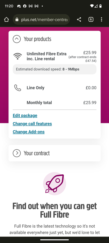

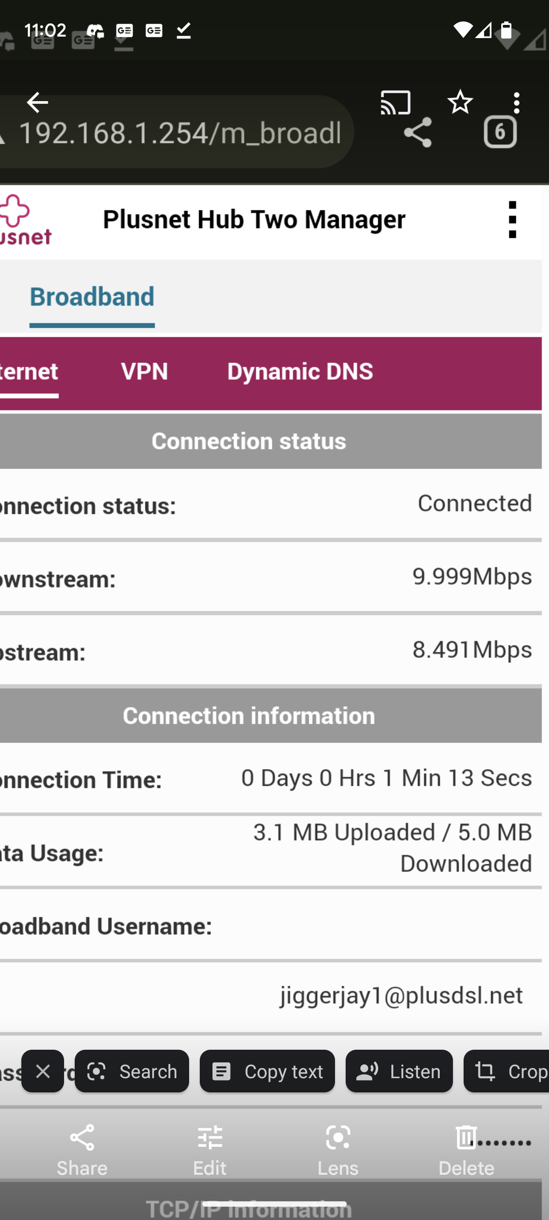

I've been with plus net for a few months since swapping over from topcashback, the whole situation is already a mess as the cashback got declined but that's another situation. My Internet is painfully slow. I am suppose to be on 70mbs but I am only connecting at 10mbs. I've tried various remidies on the router and that hasn't helped. I only have one line into the house, I haven't had "quick" Internet since installing it. I've done a bt check and it says the line should be on 80mbs, I've tried everything on my end

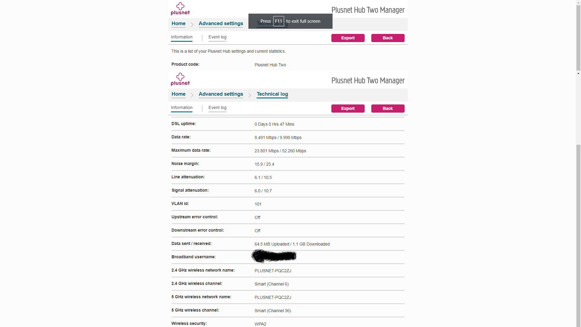

We could do with a bit more information - especially the section which is cut off at the bottom of your second screen grab.

In that case, can you use the laptop to provide the following information, please:
BT Broadband(obscuring your phone number) and BTW Performance Tester - Over a wired (Ethernet) connection if at all possible, please report the 'ADDITIONAL DIAGNOSTICS', and sight of the broadband connection status from your Hub (with the 'Username' obscured) would be a good starting point.

be interesting to see the broadband stats from the router. Those sync speeds are VERY wrong!
The downstream 9.999Mb looks suspiciously like a 10Mb profile setting , although AFAIK there isnt a 10Mb downstream profile? and 10Mb is not the top of a banded profile , VERY ODD! but the upstream is also WAY below the estimates...

Jiggerjay
Posts: 10
Registered: ‎05-02-2023
Re: My Internet seems to only be connecting at 10mbs? Yet my line supports higher speeds
Hey John, I did the DSL test above (images in first post) just did the other test with my laptop collected to the router directly

I have the technical log from the router, shall I post here?

@Jiggerjay Fair enough,  but that original screenshot was missing important information, which is why I requested it from the laptop, along with further data. I am aware you can't, unfortunately, do the phone test.
Yes, but obscure any personal information.
Jiggerjay
Posts: 10
Attached, thanks for your speedy responses.
