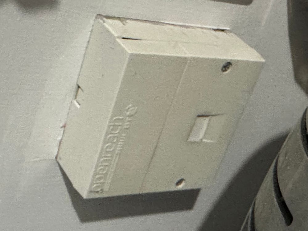

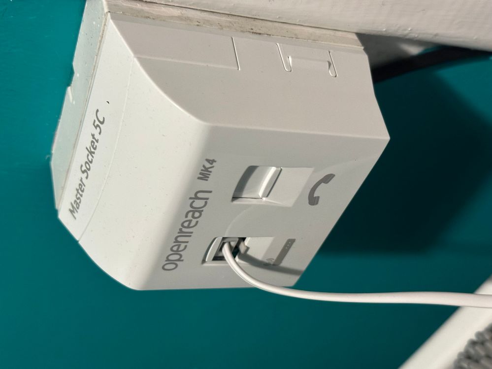

Thanks all for your input and patience. the first photo is the active line and the other one is where I would like to move it to.
Re: Moving router within house
18-02-2026 6:18 PM - edited 18-02-2026 6:19 PM
I not sure, but the second picture could be a master socket. The question is though, is it live? - I have my doubts.
18-02-2026 6:21 PM
@tpickles6 Photos of a modern and ancient socket don't really add anything of use. Can you answer my questions above please?
18-02-2026 6:43 PM
Also, if moving to it, you will need a plug in filter. Or, if the socket is live you could consider replacing it with the working one, I did not say that.
