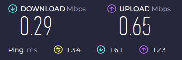

Speeds according to speed checks :
BT wholesale speed checker however says the speed is :
Which is completely wrong as nothing is working correctly due to slow speed, 30 minutes to download a 100Mb file, 240p videos etc.
It may sort itself out, but just posting here incase things don't
