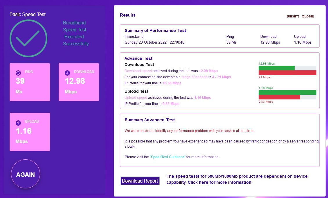

Here is the BT diag
Posts: 22,724
Thanks: 7,935
Fixes: 334
Re: Major drop in download speed
Better - but not by much.

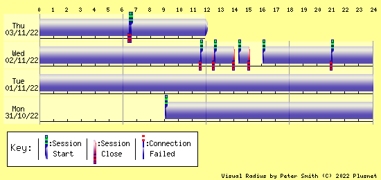

Hi there Alastair,
I've just tested the line, and it's not showing any obvious issues, logs do show that the connection is dropping again unfortunately:<img src="http://visualradius.plus.net/visualradius/generated/image16674767143459.png"/><div style="clear:both;"></div>
If a number of those were due to power cuts I'd give it a few days before we review the logs again and see if we need to take any further action.
 Adam Walker

Hi @adamwalker
The line has been stable now for 77 hours, the modem is still synced at 14800kbps but its still at 12 db SNRM.
Gandalf said there was a fault on the lead in wiring, the engineer never touched any thing outside.
The modem synced alot faster at a lower SRNM of 3db after the powercut then dropped and synced at 12db (must have been at 2100 according to your RADIUS).
