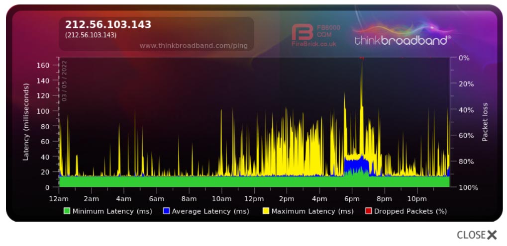

I have attached 9 files which are screenshots of the QoS monitor that I run.  The first one dated 05/05/22 is the last one when I was getting over 51Mbps down.  The ones between 15/4/22 and 12/5/22 show various jumps in the latency.  The one dated 15/5/22 should the latency go to a higher level where it has remained to date.  The average download speed is now mid 40s.  When this happened previously back in Feb 2022 after having my profile reset the problem went away until it happened again in the past few weeks.
