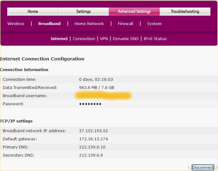

Stupid Q: is there any way to sign out "elegantly" of a xDSL connection so that the exchange equipment recognises that its not a fault? I notice for instance that the HubOne has two Disconnect buttons available within its management software...
Posts: 17,454
Thanks: 7,054
Fixes: 488
Re: Loss of ADSL Performance After Joining Plusnet
@loomajoo  The Disconnect button drops the PPP session but doesnt actually affect the DSL connection. I'm not sure that disconnecting the PPP session affects the DSL stats in any way. There's anecdotal evidence that powering down a router causes it to send a 'dying gasp' on the DSL which (in theory) is seen a a controlled DSL drop , rather than just disconnecting the line , which is uncontrolled.

@MisterW wrote:There's anecdotal evidence that powering down a router causes it to send a 'dying gasp' on the DSL which (in theory) is seen a a controlled DSL drop , rather than just disconnecting the line , which is uncontrolled.
I could believe a dying gasp from a router with a soft on/off but my HubOne has a distinctly hard on/off power button...

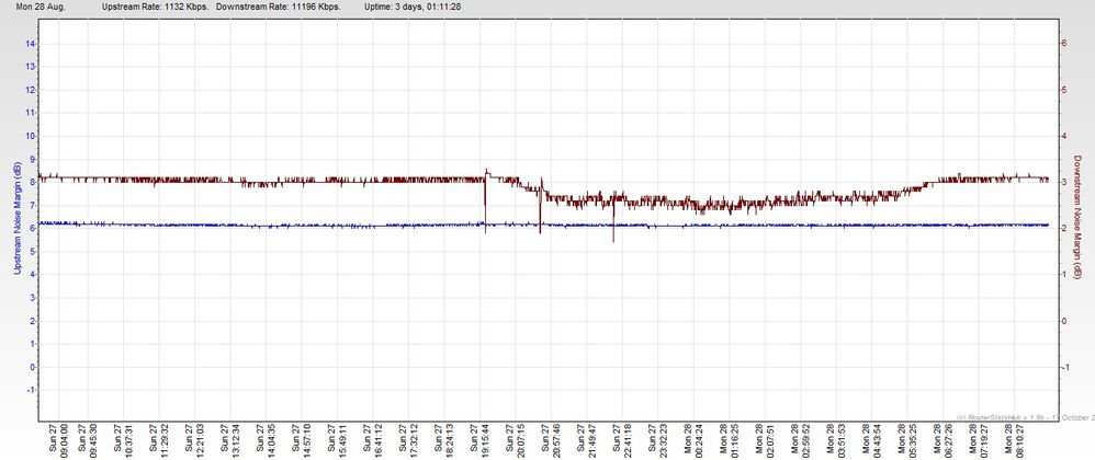

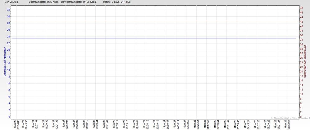

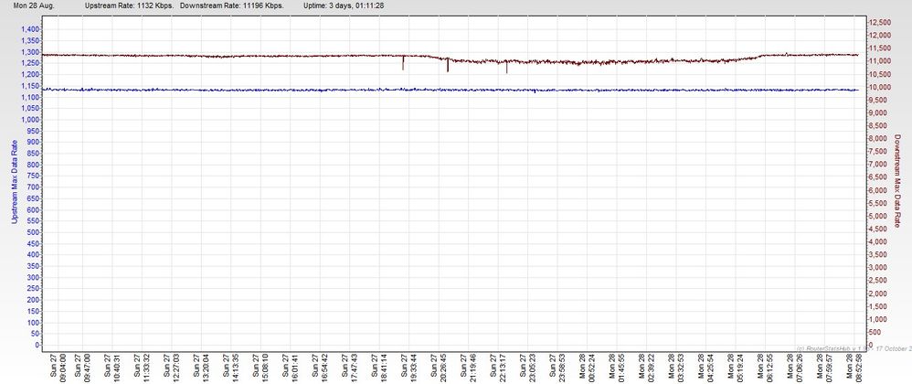

Entirely FYI (and my own sanity !) I just remembered that I did capture some line traces using RouterStatsHub connected to the HubOne.
They are inline, below, and cover the ~23hr interval from 9AM Sun 27 Aug to 8AM Mon 28 Aug (representing days 6 and 7 of the new PN service).
Each of the four trace confirms (in the header info) the router had been up 3 days with an established sync rate of 11,196Mbs. Also in trace 1 over the interval.
Trace 2 shows a steady downstream attenuation ~42dB.
Trace 3 shows a slight drop in the downstream thru-put as the SNR reduces overnight.
Trace 4 shows the detailed downstream SNR droping from 3dB to ~2.5dB overnight.
IIRC the connection stayed pretty much this way for the first ~3wks before it all slowed down.
Reported Connection SpeedReported Connection SpeedReported Line AttenuationReported Line AttenuationReported Max Data RateReported Max Data RateRSHub-NoiseMargin-20230828-090049.jpg

It is the LINE attenuation not the signal attenuation which is of concern - one of the earlier posts reported it to be 42.5dB which calculates out to 3km.

Those router stats tell a stark story!  Note that the only one of interest is the SNRM.  Sun rise / set is currently around 7am / 7pm and those are close to the horrible SNRM plot duration.  That is either AM continental radio interference (but that usually stops around 2am) or interference from IR CCTV illuminators.
I once had a horrible experience with broadband - it took months to sort, though there were a multitude of issues ... one of which was the CCTV PSU - when the IR illuminators turned on, the stress on the PSU caused it to blast out RFI.
Some of those spikes are large and will with a 3dB SNRM probably give rise to frequent disconnections.  The line needs to be checked for AC balance.

Revisiting the graphs changes: the max rate is not a sign of "improvement" as you put it but rather just an illustration of what the line might do if resync'd with the then present background noise.  The DS was running at 3dB is it the case that it is not at 6dB?  If yes, that suggests strongly that 3dB was found to be unstable.
