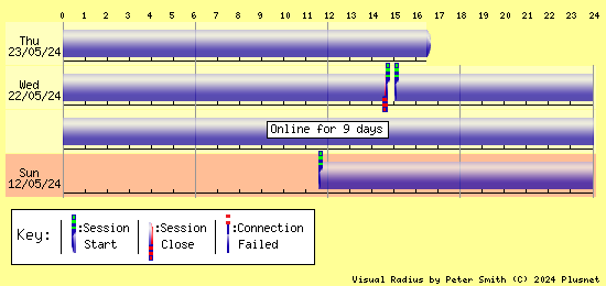

@GC007 Just to be sure that it's actually the WIFI that's dripping "WIFI means different things to different people. When the drop occurs does the DSL/broadband light flash? here @ http://visualradius.plus.net/visualradius/generated/image17164782108883.png you can see that the actual broadband does appear to be dropping. Do you have any other networking tech connected like switched, hubs, meshs, powerline adapters or WIFI boosters or is it just the router?
Can you try a device via ethernet to see if it also happens?

@James30 That appears to be one xDSL drop at 1500 - not daily at 1900 and 2000. I still think sight of the error log would be useful here.

Forgive me that was meant to say "you can see that the actual broadband doesn't appear to be dropping."
