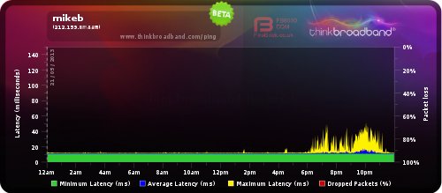

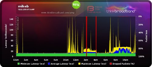

Only wandered past to check on the latest excuses with regards to webstats (or should I say lack thereof), but while here I just happened to stumble across this, so here's my 2p worth ...
This has been happening for ages and quite regularly too although not everyday that's for sure. I haven't correlated any of the problems I seem to have to any specific gateway and/or particular data centre to date ... but then again I've just about given up with it all TBH. If my fully hard-wired connection is 'acting up' in some way then I just wander off and leave it to b*gger around as it sees fit these days unless I'm desperate. I've wasted way too much time and effort trying to persevere with it or attempting to get to the bottom of whatever it is that causes problems but ISN'T down to me or my modem etc.
Here's a typical TBB graph for when I was several hundred miles away from my totally unoccupied premises for instance:
and here's another random and particularly bad one but this time with perhaps some intermittent light browsing going on but nothing of any significance if indeed anything at all. I tend to avoid doing anything of importance in peak times whenever I possibly can these days or end up giving up and trying again later.
In both cases, apart from routine and very slow mail checks at 5/10 min intervals or whatever, there's no real activity whatsoever. The 'humps' are quite often considerably worse than that as well but sometimes only just detectable. It's quite variable for no obvious reason other than presumably (over)loading somewhere.

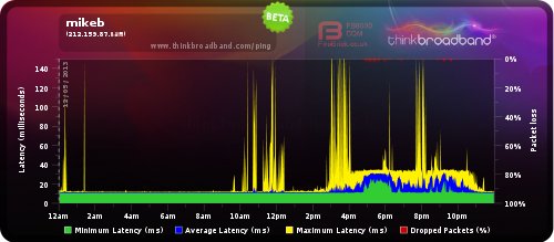

Add to that the problem with breaks in service leading to having to terminate PPP but then experiencing problems with automatically re-establishing a connection due to LCP issues almost every time I'm DLing iplayer (or other heavily managed data BUT at no other time) much like this:
in addition to the peak time 'hump' and there clearly is a problem somewhere beyond my front door and it's clearly been around for absolutely bl**dy ages. But I've pretty much given up worrying about it now. Just accept it as being all part of the so-called 'service' and take the easy option I'm afraid. I either babysit my connection when I absolutely have to or simply don't use it when it's being stupid. Ridiculous situation really when paying £22/m for very limited BW but it keeps the old blood pressure down and all that  Roll eyes
If anyone's running a book ... my money is on BT primarily responsible although with PN the merest hint of a nose behind Tongue  Not that I'm hedging my bets or anything like that of course  Grin  Best of luck trying to pin it down to something or someone Kelly, I bet it's going to be a right old PITA to say the very least !
