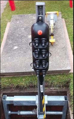

When was the FTTP installed? I'm wondering if there's some sort of "lock in" period where OR can't sell FTTP to any premise that wasn't part of the original group that paid for it.
Shown below is an 8 port CBT used in an underground chamber. Similar ones are used on overhead lines. Can you post an image of the box on the pole nearest you? If not, does it look similar to the one shown and are any ports free (each port is for one premise). On the picture shown there are 7 houses connected to this chamber so one free port).

Attached is the best photo I can get of the box on the pole, it looks a lot smaller than what you've shown, and the only cable coming out of it is the one going to my neighbour's house.
Posts: 20,869
Thanks: 6,966
Fixes: 307
Re: Line speed degrading severely over the last few months
That is not a CBT - can you see anything resembling one like that in @bmc 's photo in the area?

The CBTs would be closer to the properties - not along a road.
