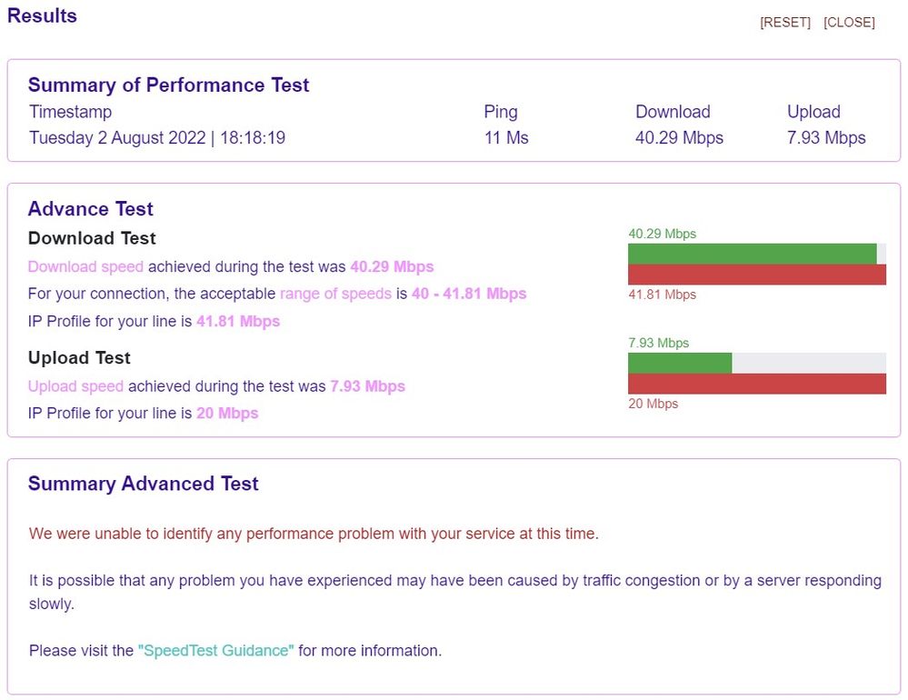

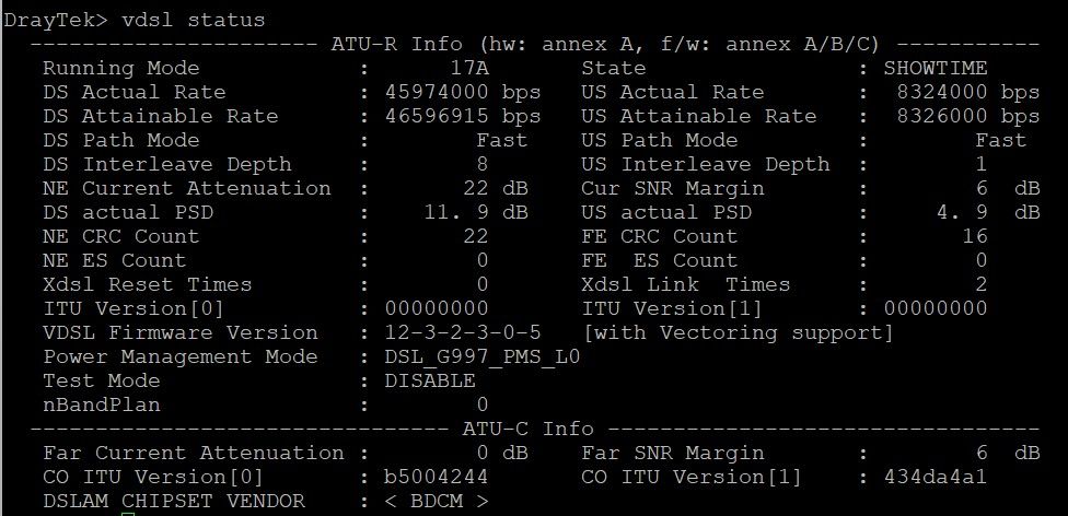

A short while ago I 'upgraded' from a Draytek 2862Lac to a 2866Lac...
My original sync speeds were typically about 60/10.
I'm now down to 40/8 - primarily because the new router (and its firmware) haven't been particularly stellar. It's been rebooted - a lot. Which has presumably caused the DSLAM to adjust my line. I know for certain that downstream SNR has been moved from 3 to 6 and upstream from 5 to 6.
Hopefully I'm now back in a stable position.
Is it just a waiting game now to see whether the router remains stable & the DSLAM does it's thing or can somebody perform any kind of reset that might speed things up - if the line has been changed to something that can be changed - profile type ?
Many thanks.

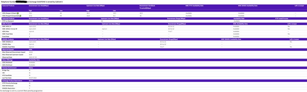

Hi Ian, apologies for the delayed staff response. We're just incredibly busy.
I've done a DLM reset for you now, but I'm not entirely confident it'll help as the line profile is showing at "Downstream: 0.128M-80M with Retransmission (Low). Upstream: 0.128M-8.5M with Retransmission (High)" which suggests there's no banding or artificial restriction placed on your speeds.
However let me know how things look within the next 24 hours.

Hi,
Thanks (and apologies for pushing!) , yes I guessed something might have been done as it has just done a resync - & as you suggested with no real change.
I can't understand why both up and downstream would have dropped by 20% if the DSLAM wasn't involved. The speed drops were consistent with the new router being rebooted - with the SNR steadily rising from 3dB to the current 6db - do you think given enough time this might be changed back automatically? (If you still have access to my line stats from early June you should see things how they were and then becoming increasingly worse after the 22nd).

@Gandalf Would you look at the upstream profile again?
That looks like banding to me!
Re: Line profile after period of instability.
08-08-2022 3:24 PM
Hi Ian,
No worries. I'm afraid we can only see 14 days of historic data and I don't know if your speed will increase by itself, but as your download speed's below the lowest estimate for your line of 49mbps, can I tempt you with an engineer visit to investigate further? If you're okay with that, when could you be available?
