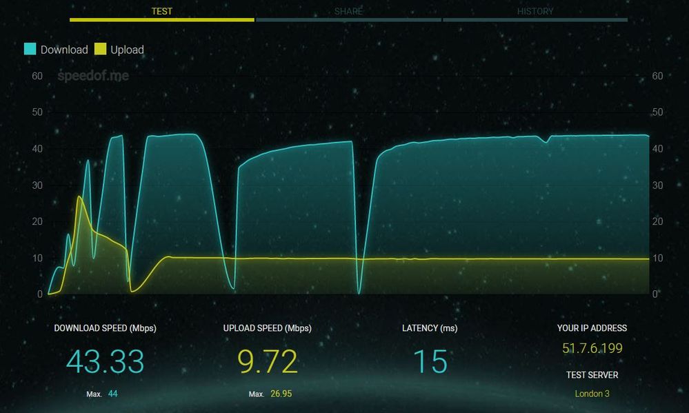

I am afraid I have had another drop in broadband and since then the speeds are down.
Please see attached. As this has happened many times over the recent years, is there anything that I can do? any suggestions would be much appreciated.
Obviously, I cannot complain as the speeds are still above the contract agreement. But usually they are 60-62 Mbps and they drop significantly after an outage.

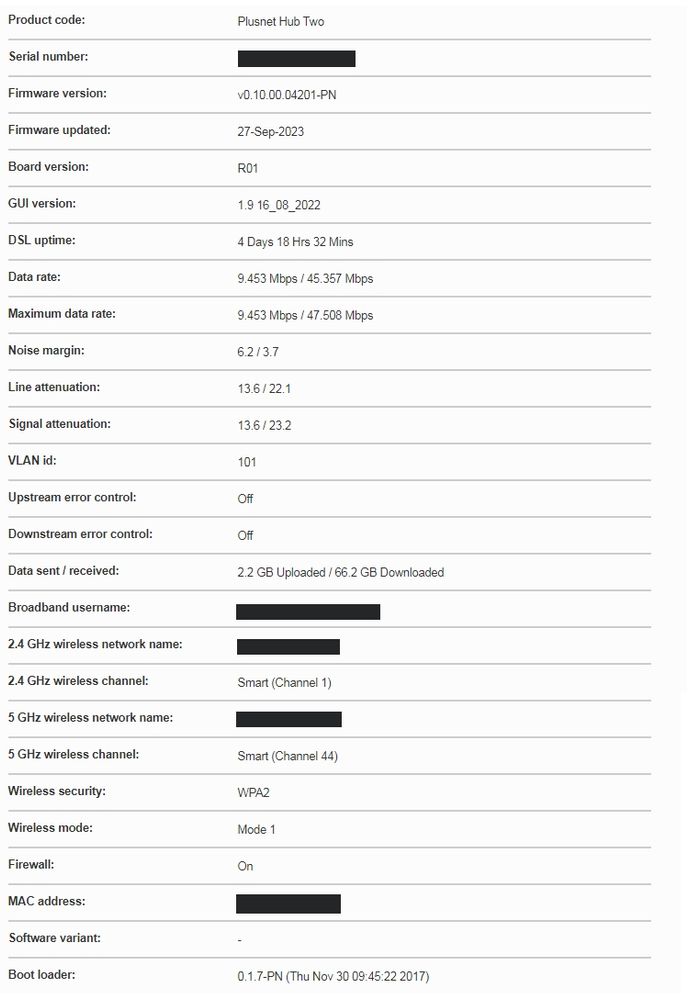

I would expect far better with those line stats - these are mine and I get 80/15

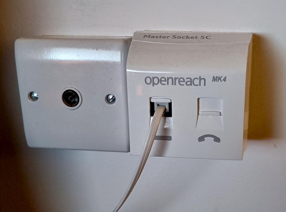

The cable from the socket to the router is not ethernet cable. It is voice grade twisted pairs or should be. What is its cross section - round or flat / d-shaped? How long is it?
It's a cable from the phone socket to the router that came with the router (see pic).
Does the NTE5 has a filtered faceplate or are you using a 'dongle' filter?
See pic.

This information is really helpful. Do you have a telephone handset or can you borrow one? Have you got the plugin filter supplied with the router?
Good to see that you are using the xDSL cable supplied with the router. That will be of an appropriate quality.
Are there any other telephone extensions?
