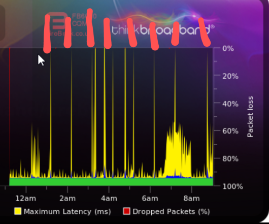

So this is where i decided to take matters into my own hands and run 2 peices of monitoring software, one widely know as TBB and another called Grafana so i went ahead and setup a boadband Quality Monitoring by TBB on my network along side Grafana gather some data so that i can show you my issues.
Here is my TBB: https://www.thinkbroadband.com/broadband/monitoring/quality/share/145eb3f4cc20cba1cb5bb021f030411885...
You will see i have moments with large yellow peaks, the monitor only reads up to 160ms, but after using another tool called grafana, i can see the packet loss latancy is reaching 4000ms.

@Psycho_Shaft Something is horribly wrong there, but packet loss graphs alone are not a great deal of use. We need some solid router/modem statistics to attempt profiling the issue. What detail can you get from your current set-up?

@Psycho_Shaft   The TBB graph suggests large amounts of traffic which is shown as the yellow peaks. Switching off devices, or monitoring bandwidth use on each may highlight a device using excessive bandwidth.

I am not sure if you can see on the graph the Red dots at the top of the graph. this is the problem.

@Psycho_Shaft   yes I know, but they are a result of the load/traffic on the line/router or what ever device you have set to respond to the TBB pings.

Yes i understand, my line is busy because i am doing broadband speed tests every 5 mins for documentation purposes only, i am conserned more about the RED dots on the top of my graph with 100% packet loss.

Red dots

A 100% packet loss would be a line all the way to the bottom of the chart, not just a tiny dot. which is just a packet or two at the same time that you max out traffic on the line.
