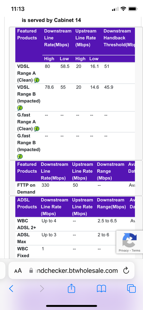

Anyway, I found the BT Address checker and here is the result:
This seems to indicate I should be getting more than I am!
(Also it says FTTP on Demand Availability Date is "Available" but further down says "FTTP is not Available" - [-Censored-]?)

FTTP on Demand and WBC FTTP are two totally different products - and you don't even want to look at the costs for the former!
