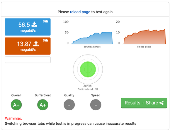

@bazzer wrote:
I began to wonder why it was taking so long and carried out random speed tests.
Try running the DSLReports speedtest  and clicking on the green [DSL] button.
If your router is managing your upload path adequately, then you should see a resulting "BufferBloat" score of "A" or "A+", otherwise you have a starting point for solving your problem.
If your router does have a QoS setting or a upload rate limiter, then start by trying limiting the maximum upload rate to about 90% of your usual upload speedtest result (so 90% * 18.24Mb = 16.4Mb), and repeat the above test to see the improvement, and repeat as necessary changing the percentage (up or down) to achieve maximum throughput and minimum latency.
If your router doesn't have these controls, then does the software on your computer that performs the backup to the internet, have any sort of rate limiting ?  If so try setting that limit to say 80% of your upload speed (so 80% * 18.24Mb = 14.6Mb).
At least doing that means that you won't be saturating the upload connection, which means while a backup is in progress that your internet will be otherwise usable, and although you have artificially limited the backup speed by 20% the actual throughput loss will probably be less than 10%.
@Anonymous Below is the result of the DSL test. I'm assuming this all looks good?
However, despite the backup completing this morning, I have still experienced a combination of very slow download / upload speeds, as well speeds that I consider to be normal.
