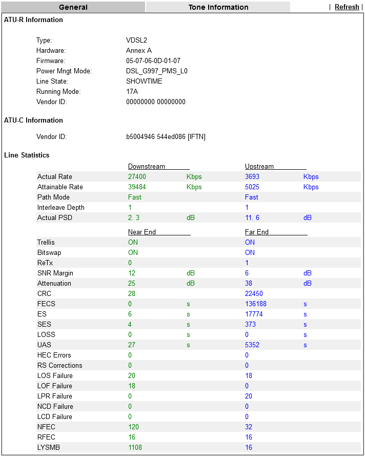

Got a text message a short while ago saying the engineer has finished, not sure what they actually did after leaving the house but I didn't get any of the disconnects that they said I would, and having just done another quiet line test there's still the same static on the line.
Obviously there's still a problem, and while I haven't had the repeated disconnects throughout today (just when the engineer disconnected things during the visit), my connection speed has lowered to 27.4/3.6 as of this morning, likely as a result of the DLM trying to get a stable connection.
At this point I'm not sure waiting a few days as the engineer advised will change anything, I'd have thought any potential fix would have both been immediately noticeable and would have resulted in a connection drop to facilitate it.

Did someone at PN just do a DLM reset on my line?
Engineer came out this morning and swapped pairs, but advised against a DLM reset until we were sure that the line was entirely faultless, because a DLM reset would mean potential disconnects as it retrains and thus we wouldn't actually know if any connection stability issues were because of the line or not.
I've been keeping an eye on the line, as I was advised to do, which is why I noticed a disconnect followed by a change in the speeds it was connecting at.
Before:
And now:

@Method0ne I very much doubt this was a manual DLM reset - your US SNR figure is too high at 9dB - looks as though whatever the engineer did hasn't fed through the system yet. Your downstream speed is also very low - which ties in with the high SNR.
I'd give it at least another 24 hours before posting that data again.

The first image was before the connection speed changed, and the SNR figures have also changed as per the second/third images.

My latest stats show a downstream SNR of 5 and an upstream SNR of 6, shown in both the 2nd and 3rd images in the post I made asking about whether the DLM had been reset, so you're referencing stats that are from before the disconnect/reconnect at a higher speed that is also shown in image 2/3.
Hence why I was asking.

My apologies - your router provides a lot of data - some superfluous - and I misread the post. It appears that whatever he did must have influenced the DLM - PN don't respond that quick.
My corrected advice is wait and watch.
