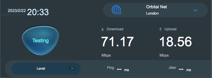

@Dan_the_Van Interesting point on the line attenuation, good spot. Here's another shot of what it currently sits at after the engineers visit this evening.
As to the filtered extension - Everyday is a school day and I'm certainly learning new things thanks to you all.
Small update. Several drops today with one large one before I went out. Skimming over the logs here it looks like that's been the case all afternoon. Anyway, just after I got home there was a knock at the door. To my surprise an OR engineer stood, apologising for not notifying of his visit beforehand and that I may have experienced some outages as he was testing the line. He ran some tests, found a High resistance point within 10 meters of the socket, threw a new master socket base plate on and speeds immediately returned to what they were in November last year:
